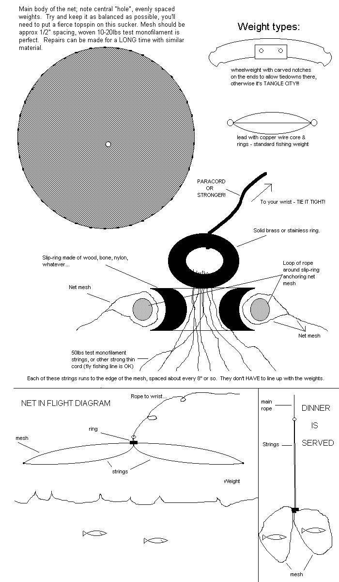

In this first post I'll show how they're built if you want to home-brew one, and the basics of how they work.
They can also be bought commercially.
How to throw them and "tactical notes" can wait for tomorrow, this graphic took a WHILE to do
I used of one of several sizes of these suckers on a regular basis for about eight years. NOTHING gathers food as fast or efficiently...NOTHING.
(In case it's not clear, the "middle graphic" is a close-up of the main junction where the slip-ring, wrist rope and mesh all "come together".)
Jim

A couple more contruction details:
The outer edge of the mesh is a single loop of "light rope", paracord grade or similar. That anchors the mesh, the weights and the "draw strings".
The amount of weight is a tradeoff between sink speed (nails more fishies) and your ability to chuck the thing long distance. About 2oz per 8" of circumference is a starting point...all the commercial ones I ever bought I ended up adding some heft.
In case it's not clear from the "dinner is served" pic, the slip-ring has slid down the drawstrings, stopping only when it jams up on the circumference rope and weights which are too bulky to fit through the slip-ring.
A slip-ring with neutral bouyancy is probably best because it'll drift with the mesh during the sink. A slip-ring made out of a heavy piece of brass might make the center drop so fast it keeps up with the drop of the lead, allowing more fish to swim out from under...this is suboptimal.
The slip-ring shown here is of classic Polynesian type. Most commercial ones will have a simple brass or stainless ring with the mesh anchored to it directly...that means the center of the slip-ring isn't very "slick", which is a desirable feature, it'll snap closed faster when you yank the rope in deep water. If you're letting it sink to a sandy bottom then closure speed isn't an issue.
Jim

Buyer beware -- some commercial throw-nets are intended for shallow sandy bottom work only, as they have no draw strings, no slip-ring, no hole in the center of the net, and cannot be used in deep water without modification.
