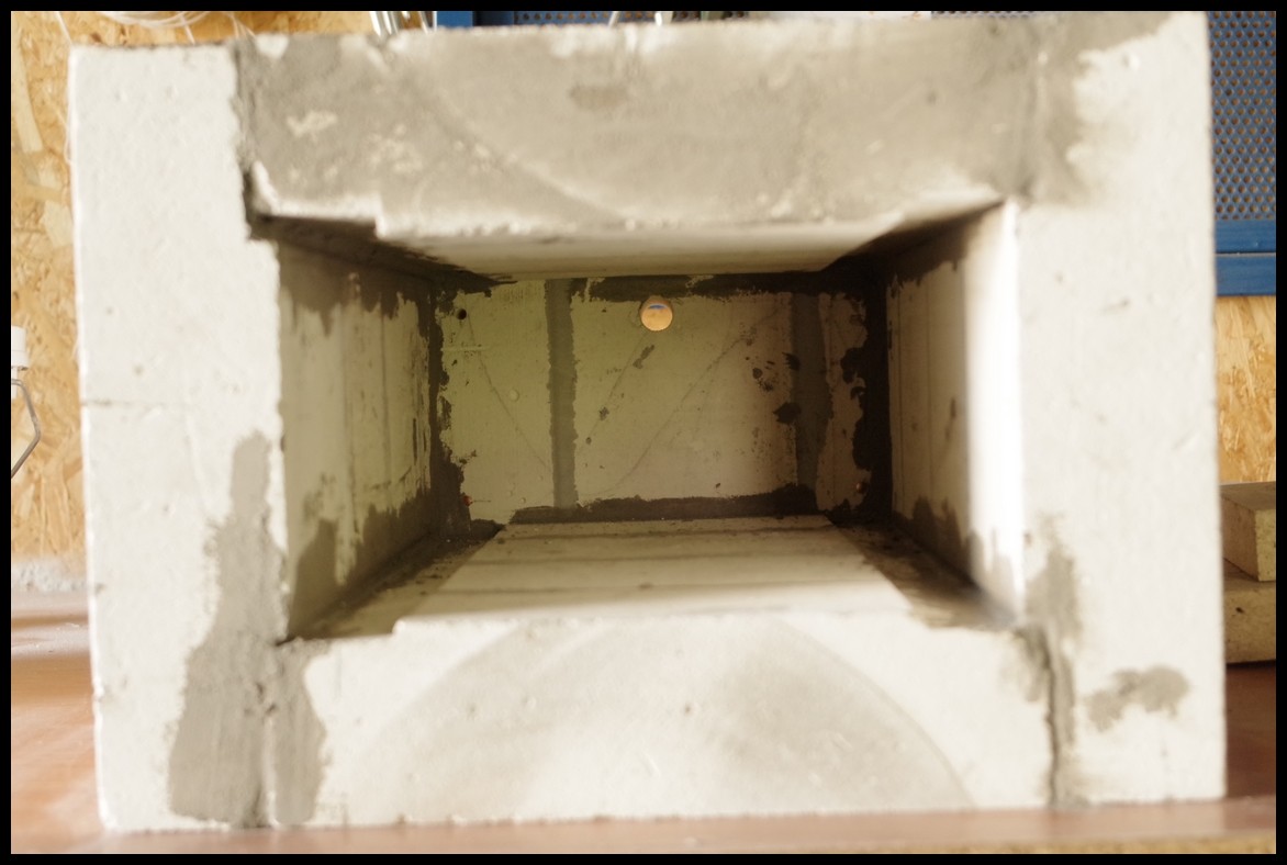

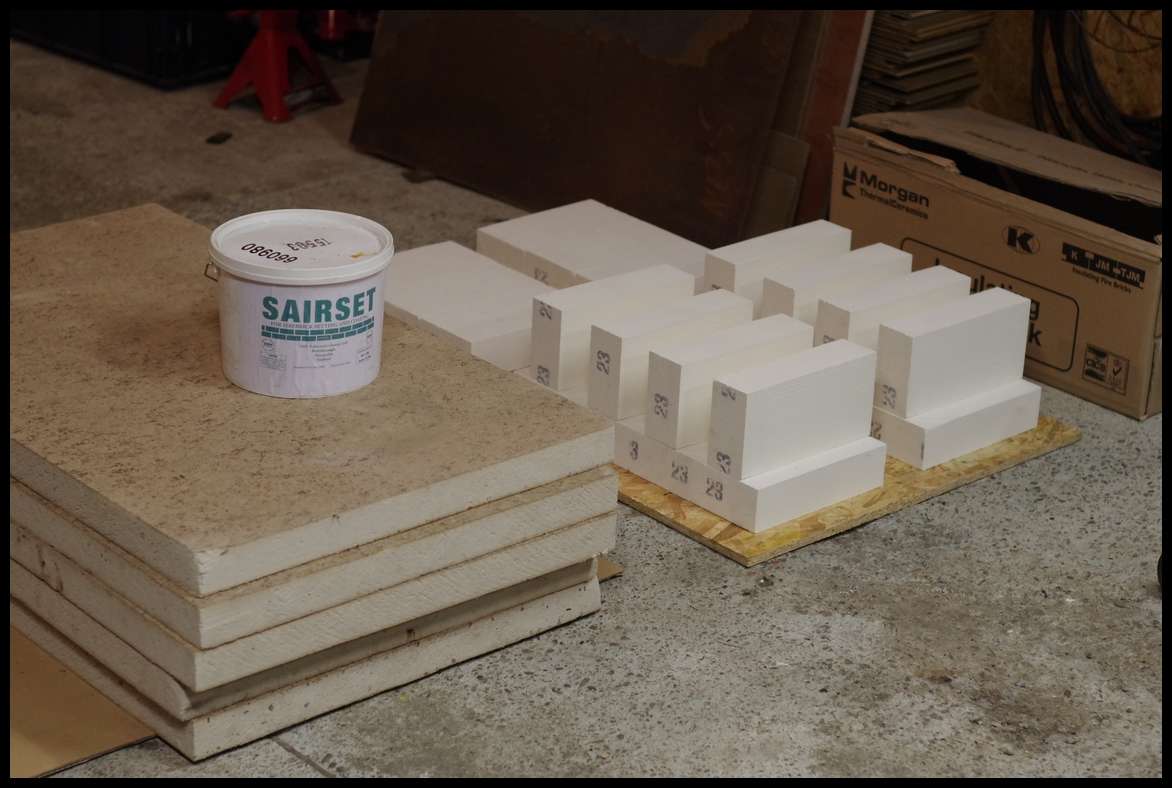

Finally materials arrived and I can start making my own knife kiln :D
Materials for chamber and insulation:
Morgan Thermal Ceramics JM23 250x124x64
Morgan Thermal Ceramics Superwool Plus 1100 50mm
Stuff on photo is for only ONE kiln :)

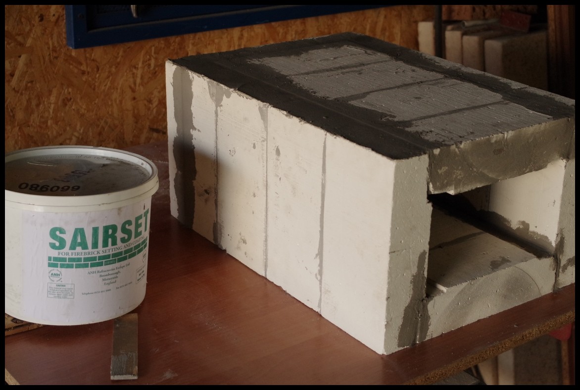

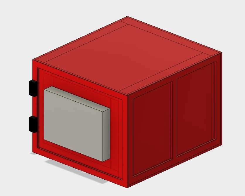

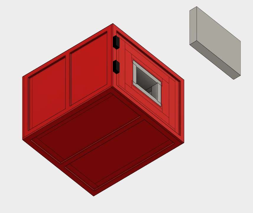

And how this will look:

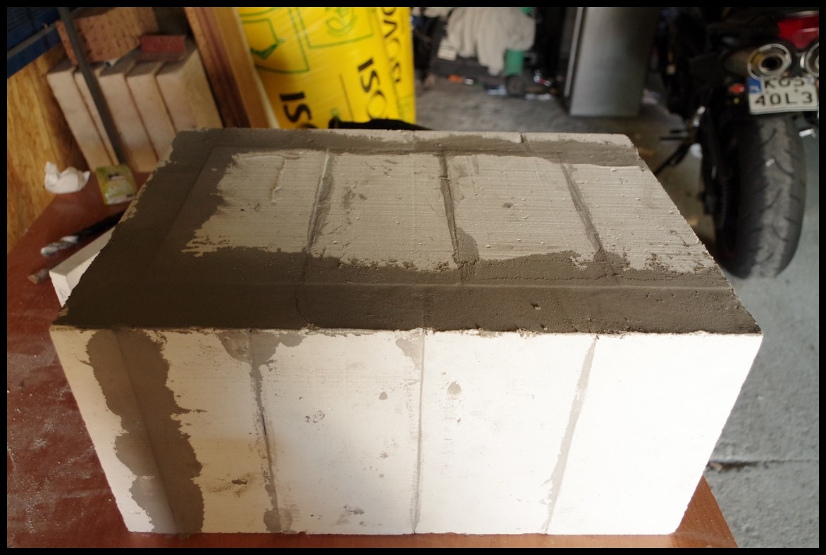

Hey,
What is the best and safe way to cut in that bricks ?

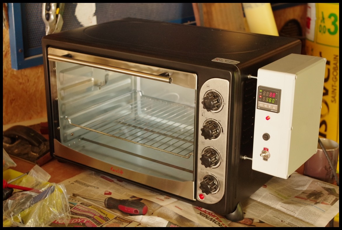

Also got now a oven for tempering :D
Just need to make normal PID regulation and some better insulation.

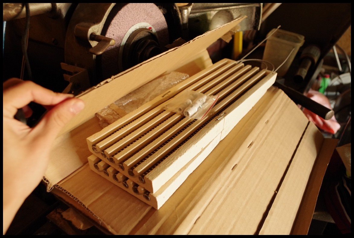

And what will go into slots ;)
2x 1,5kW heating module.

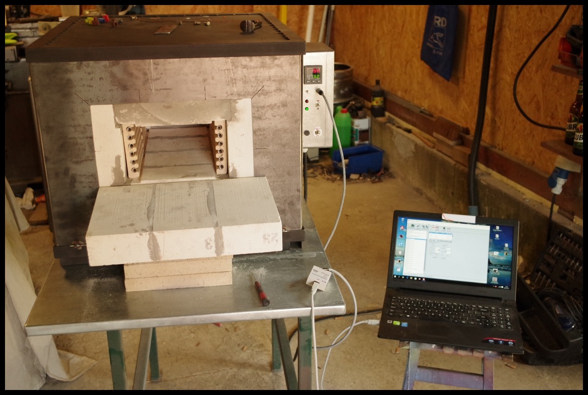

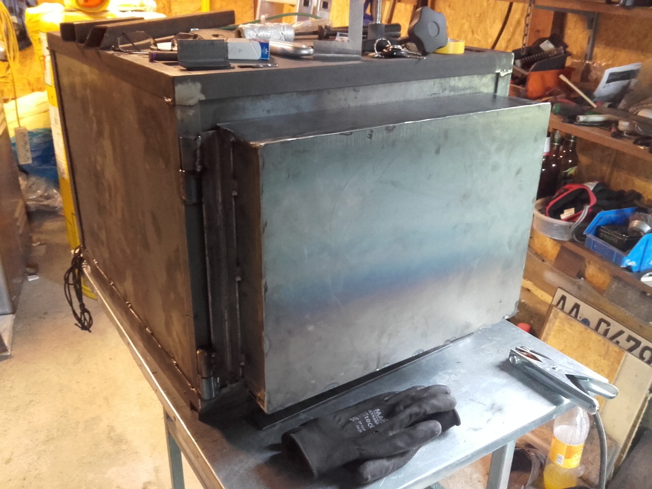

Kiln will be finished in Friday :)

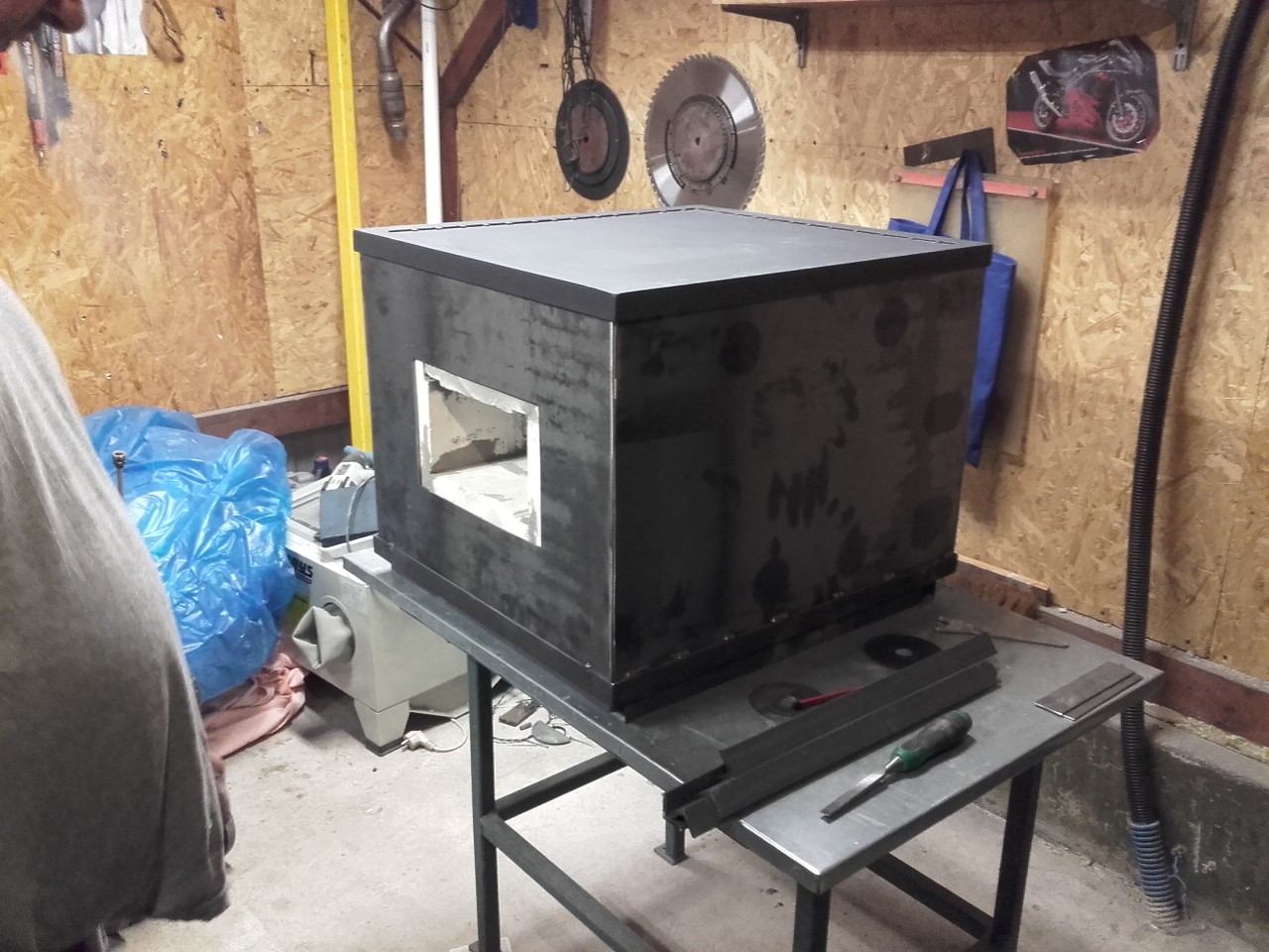

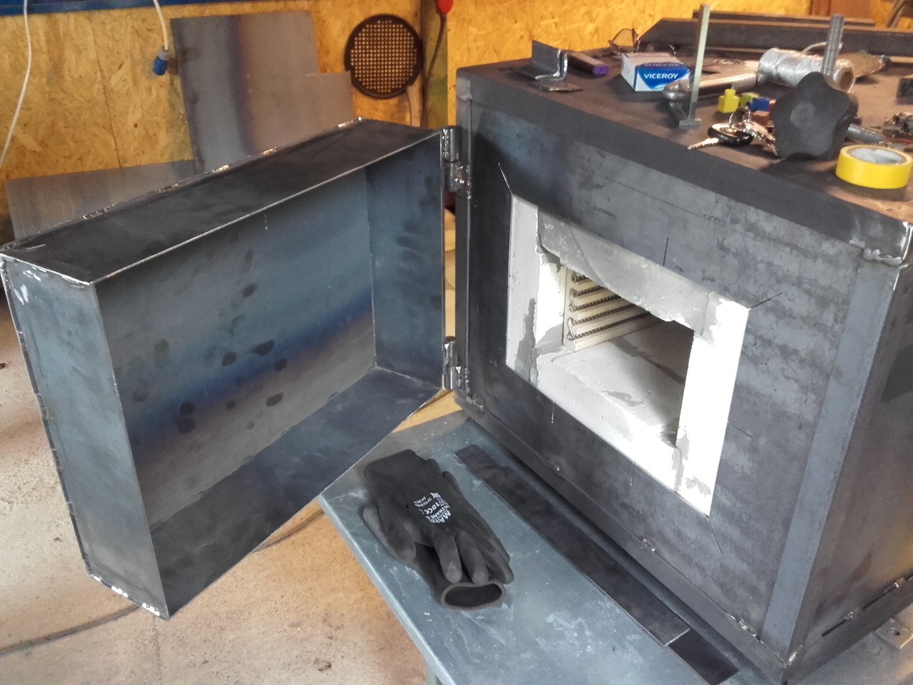

Today going to get materials for enclosure :)
2mm steel and some heat resistant Paint.
Will be beautiful black :P
Last welds and making insulated door , then Connecting to Control Unit and will be ready :D
Lookin good, it seams like we are having an oven build off between the two of us. You are further along then I. I did finish my door today and tomarow I hope to make door brackets and lay the brick.
