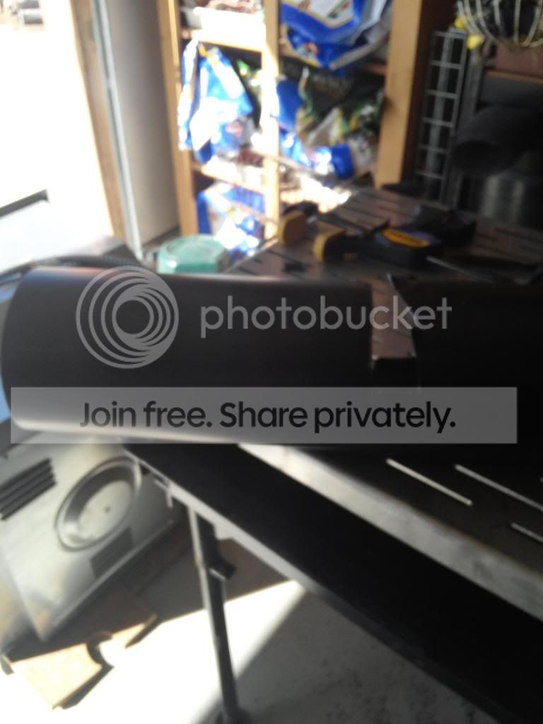

I started out with a long piece of 6 inch diameter stove pipe. I cut it into a 12 piece section:

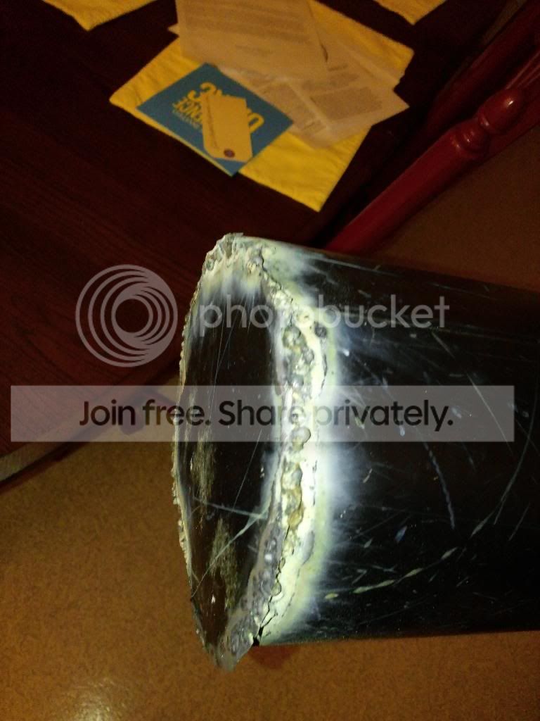

Then (with the help of a friend), I welded one end of the stove pipe closed with a disc I cut out of the remaining pipe:

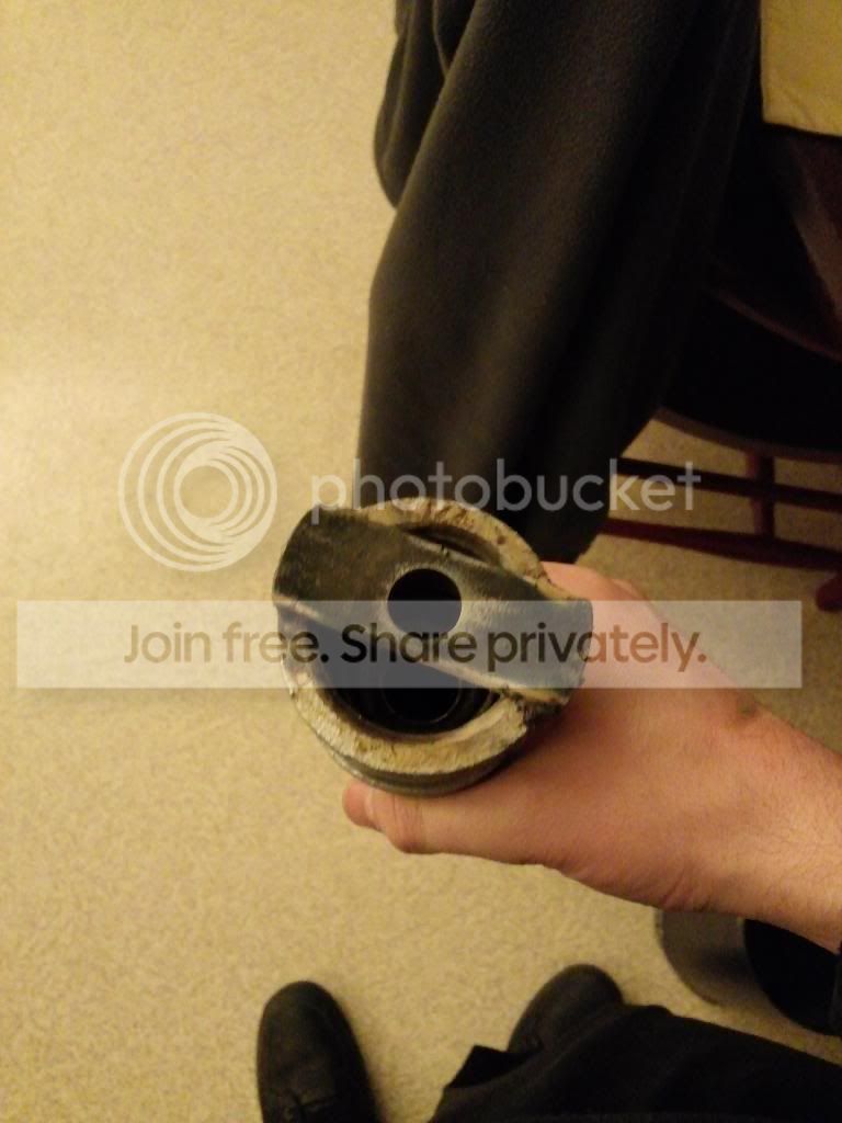

Here is the back of my venturi (I used this website as a guide:http://www.rayrogers.com/venturi.htm). The crossbar I welded on is not perfectly centered, but it should do the job well enough:

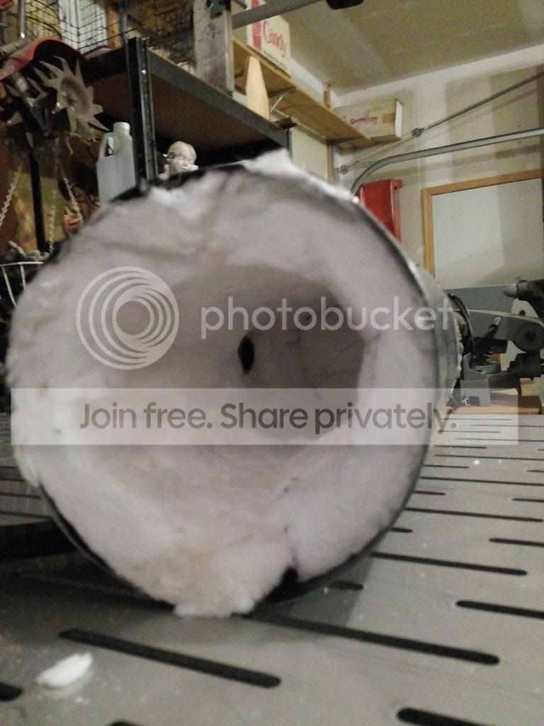

I then drilled a hole in the stove pipe and cut out my inswool (I'm using 1 inch). Here is a pic of the inside after the inswool was put in place:

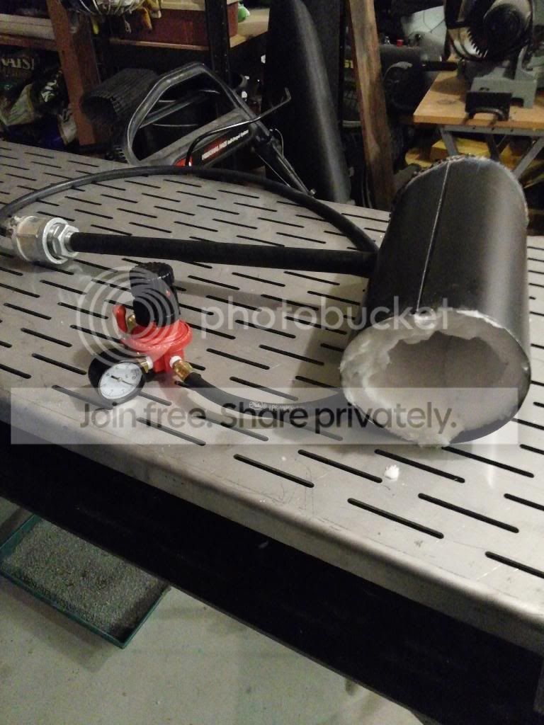

Here is a pic of the whole contraption (that is a regulator, gauge, and hose from Wayne Suhrbier at hightemptools.com)
I still have to put two coats of satanite on and a coat or two of ITC-100 (hopefully I can do this Sunday or Monday). For a door, I am just going to stack a few fire bricks. If you guys think I need a floor, I will probably just bake some cat litter onto the bottom of the forge.

For a floor, put an extra thick layer of satanite and cut a thin soft firebrick for a floor. You can bang through coated kaowool pretty easy.
I didn't see your entire burner. But the jet does need to be centered and aimed right down the middle. It also must have a conical inlet and burner tip. The flow of gas draws in air, but the burning gass espanding in the flame holder (the conical tip) causes the venturi effect drawing more air in as it combusts and expands away. Venturis take tuning and proper design to be truly efficient.
Looks good. Should be a cool little forge. Kudos to you for DIY and taking kn this project at your age. Are you putting legs on it?
