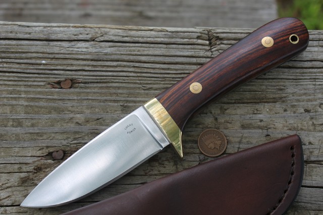

To me this last one marked --- Forge is a super design for a hunter as well as a semi skin style that would also work great. Frank
