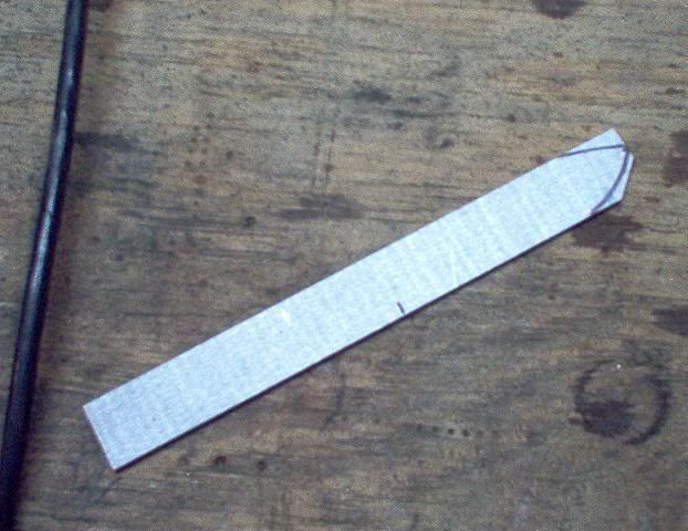

As requested here are some pics building a PSK knife showing the steps up to heat treat.
First is the barstock cut and marked for shaping.

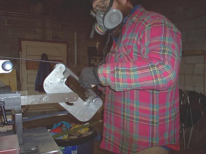

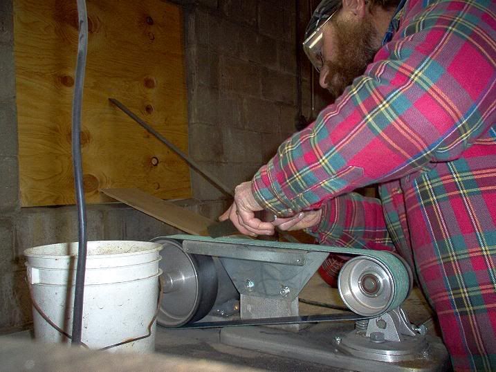

Next, on the 2x48 grinder for profiling the blade and pommel end.

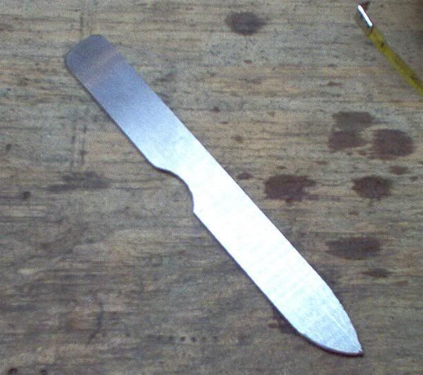

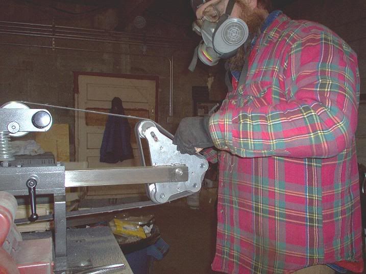

Next to the 2x72 grinder to shape the finger cutout.
This is the profiled blade ready for grinding.

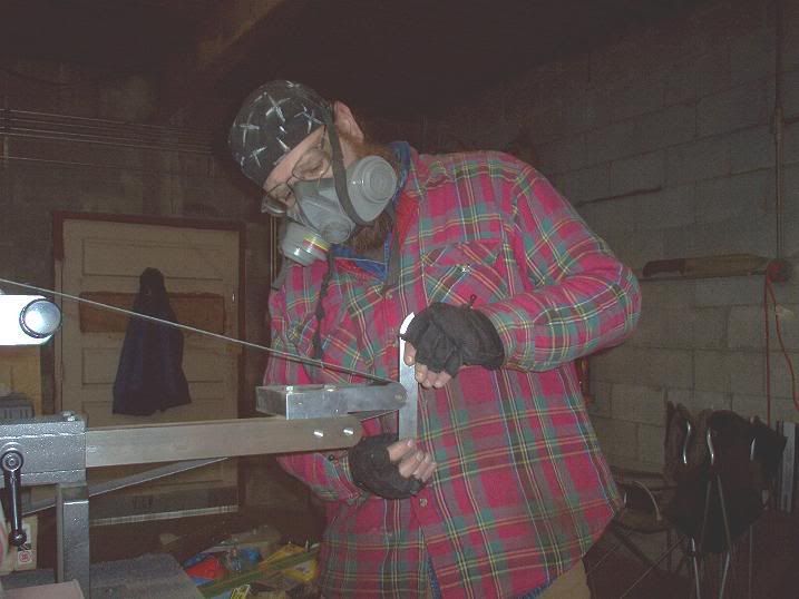

When I grind the blade, I flat grind part way.
Then I switch to the rotary platen to convex the rest of the grind.

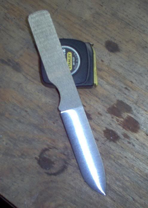

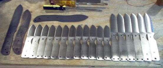

This is the knife after grinding.
Next I stamp my mark and steel type, then drill the holes in the tang.
These are 18 PSK knives ready for heat treat and temper. Also shown are 2 Nessmuks and a Kephart HTed ready to finish.

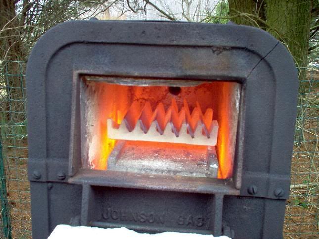

Started HTing today. Here are 6 in the furnace.

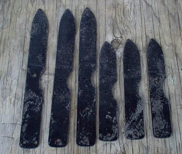

After quench ready for temper.

Question. What kind of furnace is that??? Details, links would be much appreciated. I'm tired of using charcoal!
