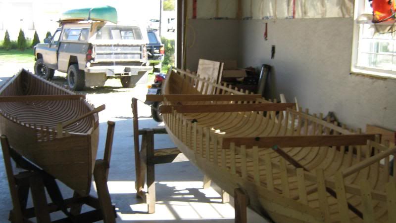

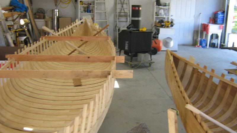

The shop
Both boats

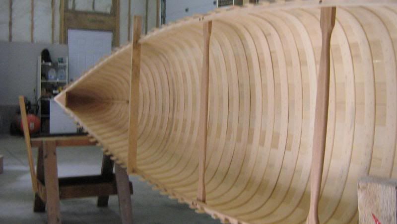

This canoe is made of Yellow Cedar
the other in the background has yellow cedar ribs and western Red cedar for planking

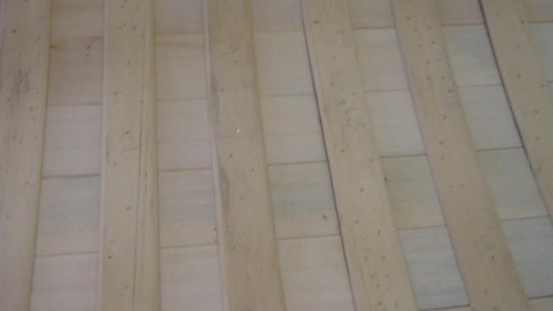

Ribs and planks of yellow and red cedar
Planks and ribs of yellow cedar
The yellow cedar boat will have Mahogany seats decks and thwarts and outwales
The other boat will be tricked out in some fine maple including birds eye decks.

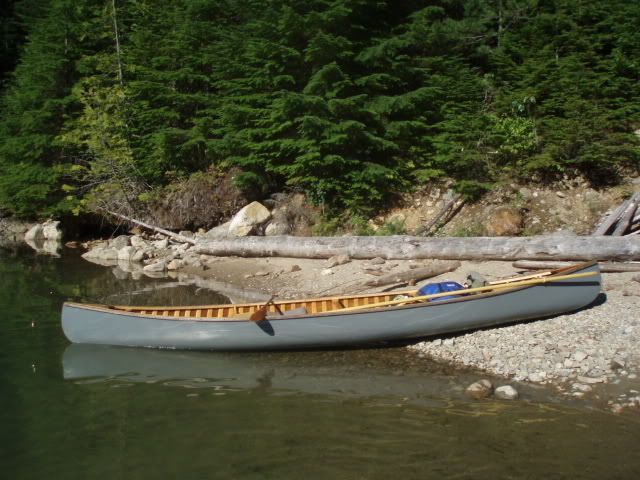

Heres a picture of one built for my brother-It just had to be paddled to work all the bugs out of it before he got it
Dan'l

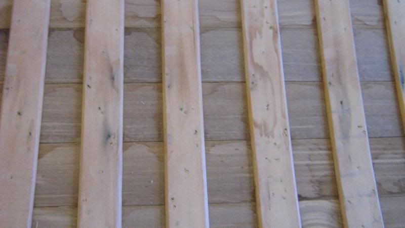

The planking is done,the canoes have been treated with a brightener to take out a few stains,warm water is put on the outside to swell out hammer blosoms,a few cracks in the planks epoxied.Planking is 1/8th inch thick so sometimes a few cracks happen

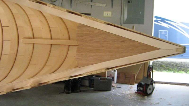

Thwarts and decks have been installed
This boat has Mahgony for those
Long view on its side
They are getting close but a few steps remain

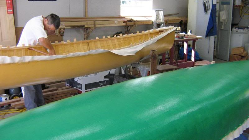

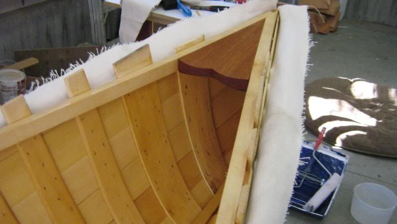

Just an update on progress
Canoes have been treated with a 50-50 mix oil and turpentine, canvassed and the weave filled and we are now painting and varnishing
A coat of varnish
view of mahogany deck
Varnished planking
