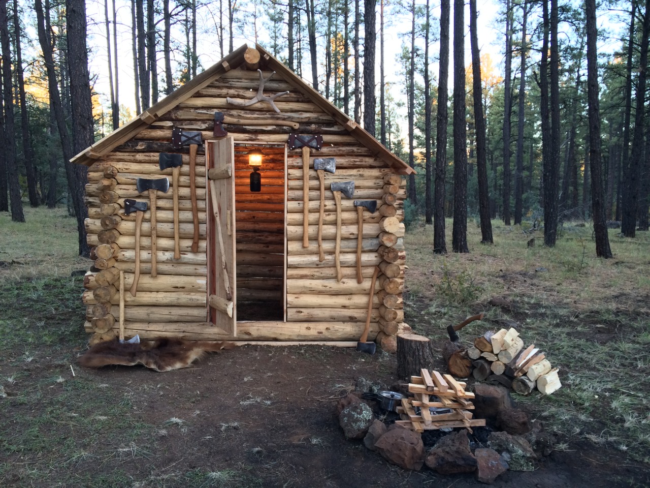

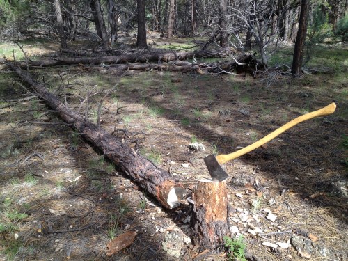

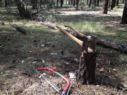

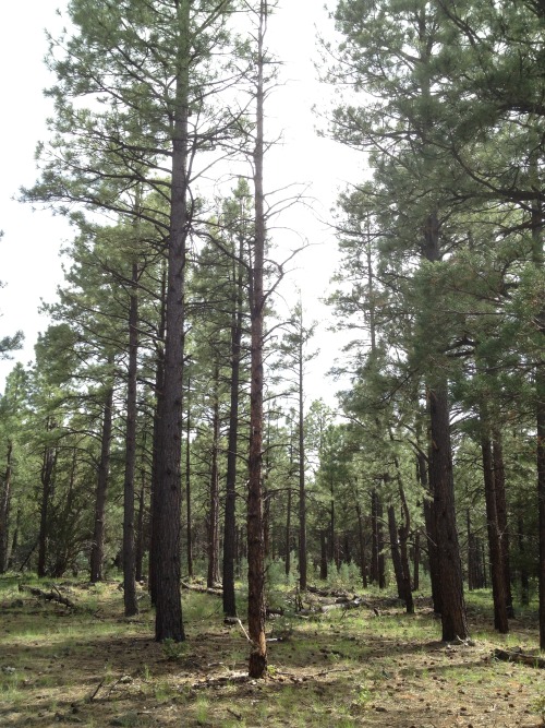

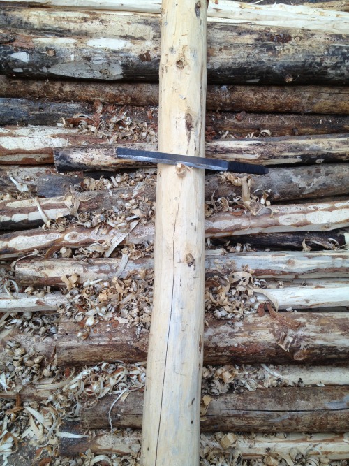

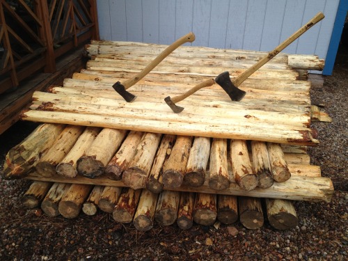

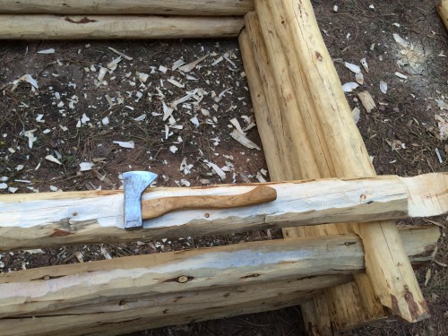

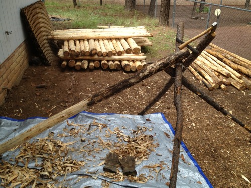

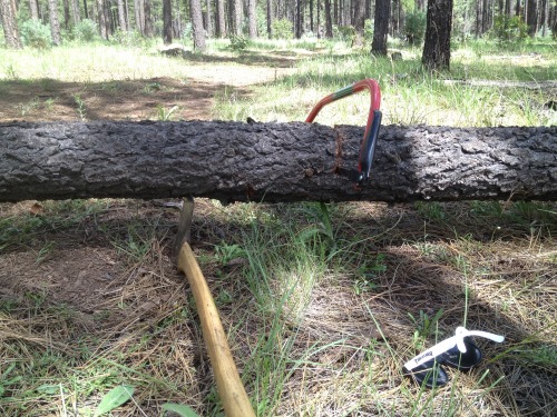

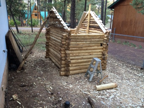

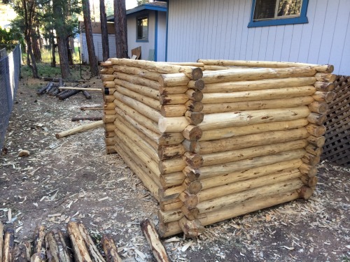

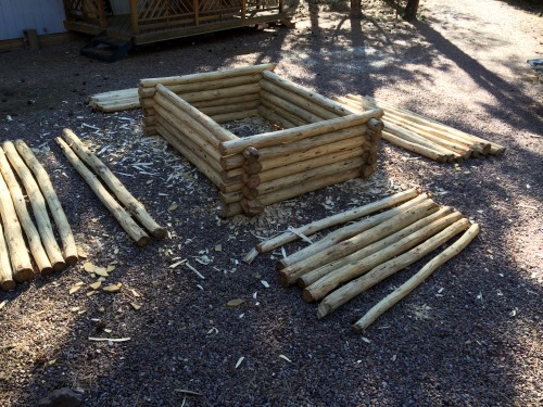

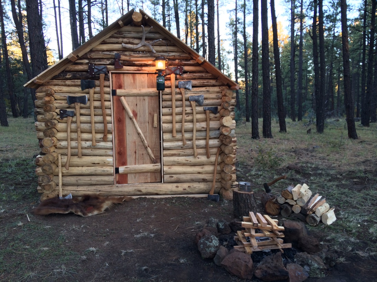

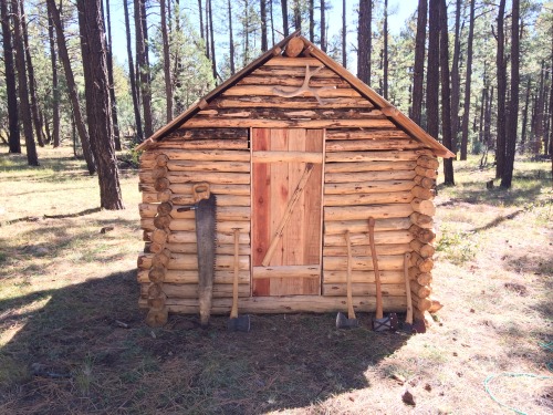

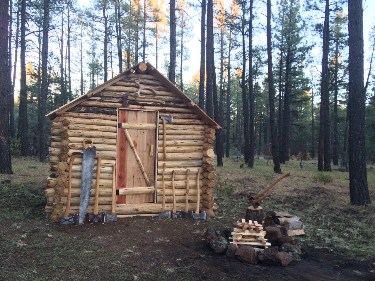

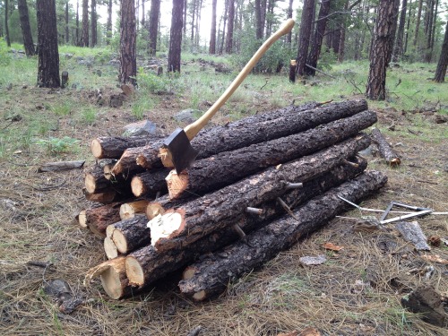

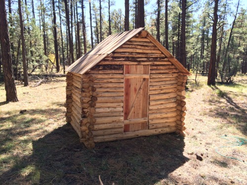

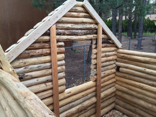

I finished this last month but didn't get around to posting the pictures until now. Here's a very small log cabin that I built by myself during a visit out of state. Made from Ponderosa Pine logs.

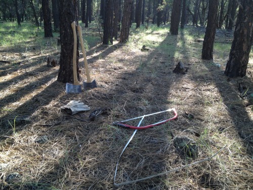

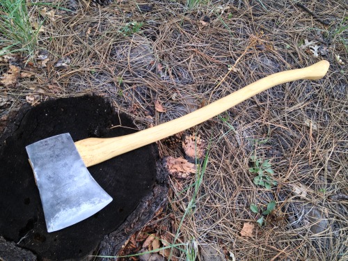

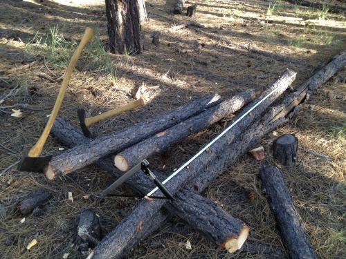

My Rogers "Leader" CT was used for 98% of the felling work.

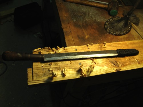

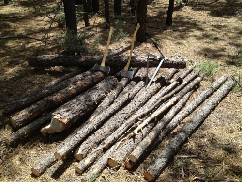

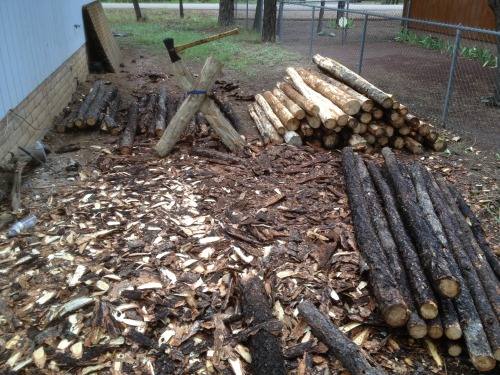

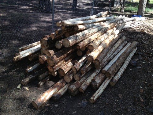

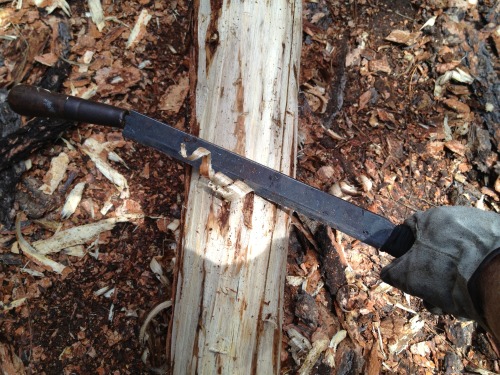

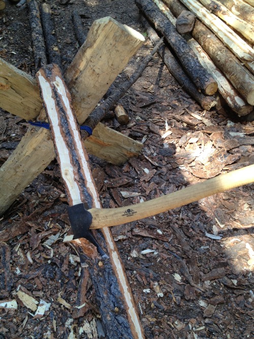

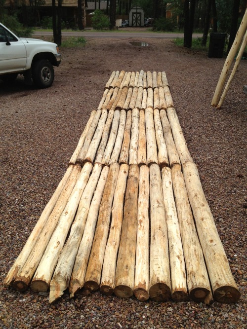

Peeled/debarked the logs by hand with axes and a homemade drawknife

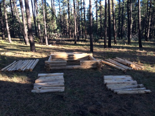

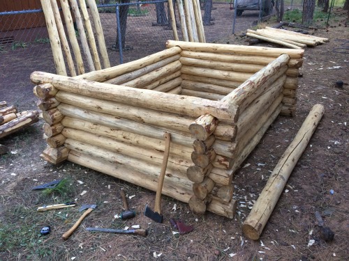

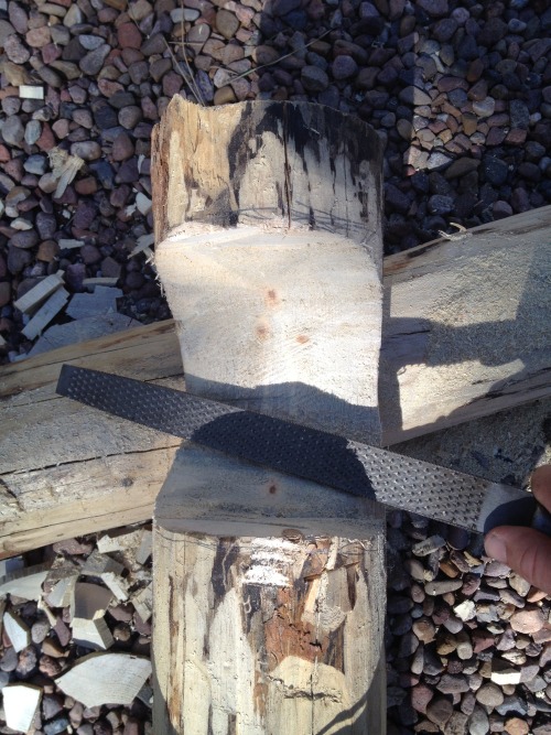

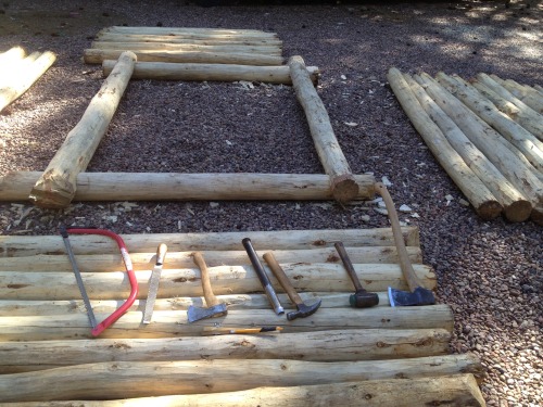

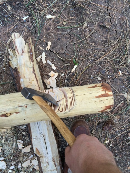

Lots of hewing and straightening

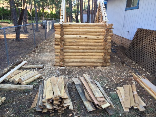

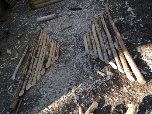

Making the gable ends

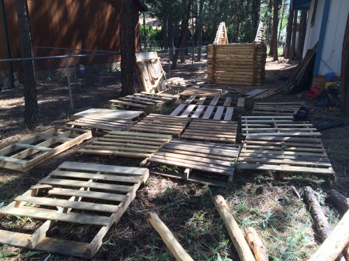

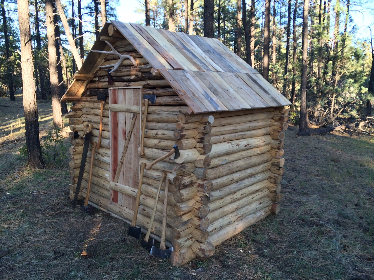

Made the roof out of reclaimed wood from pallets

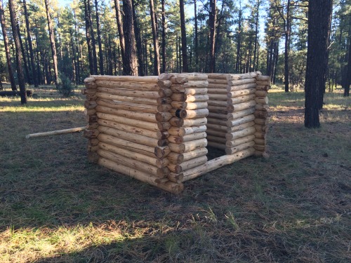

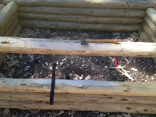

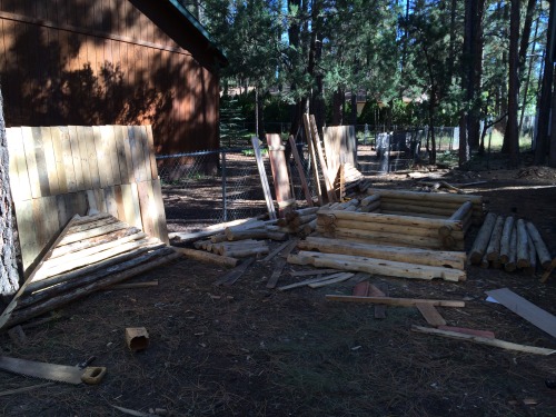

Disassembly
Reassembly
Very cool. Good job. Personally, I would invest in some metal roofing to prolong the life of that building.
Holy cow! Brother you have way more energy and gumption than me. Have always dreamed of pulling off a stunt like this (on a slightly larger scale mind you; as in making a tiny hunting cabin) but you just went out there and 'done' it, roof and all. No chainsaws or electric planers, drills or circular saws either. Downright and outright built "by hand". Congratulations!
Now comes the battle with keeping out mice.
That's excellent. Great to see the tools being used and a lovely wee cabin to.
Those are Proenneke notches. I'd recognized them anywhere. :)

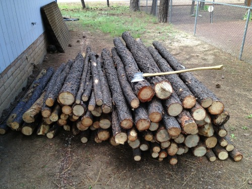

How long did you cure/dry the logs for?

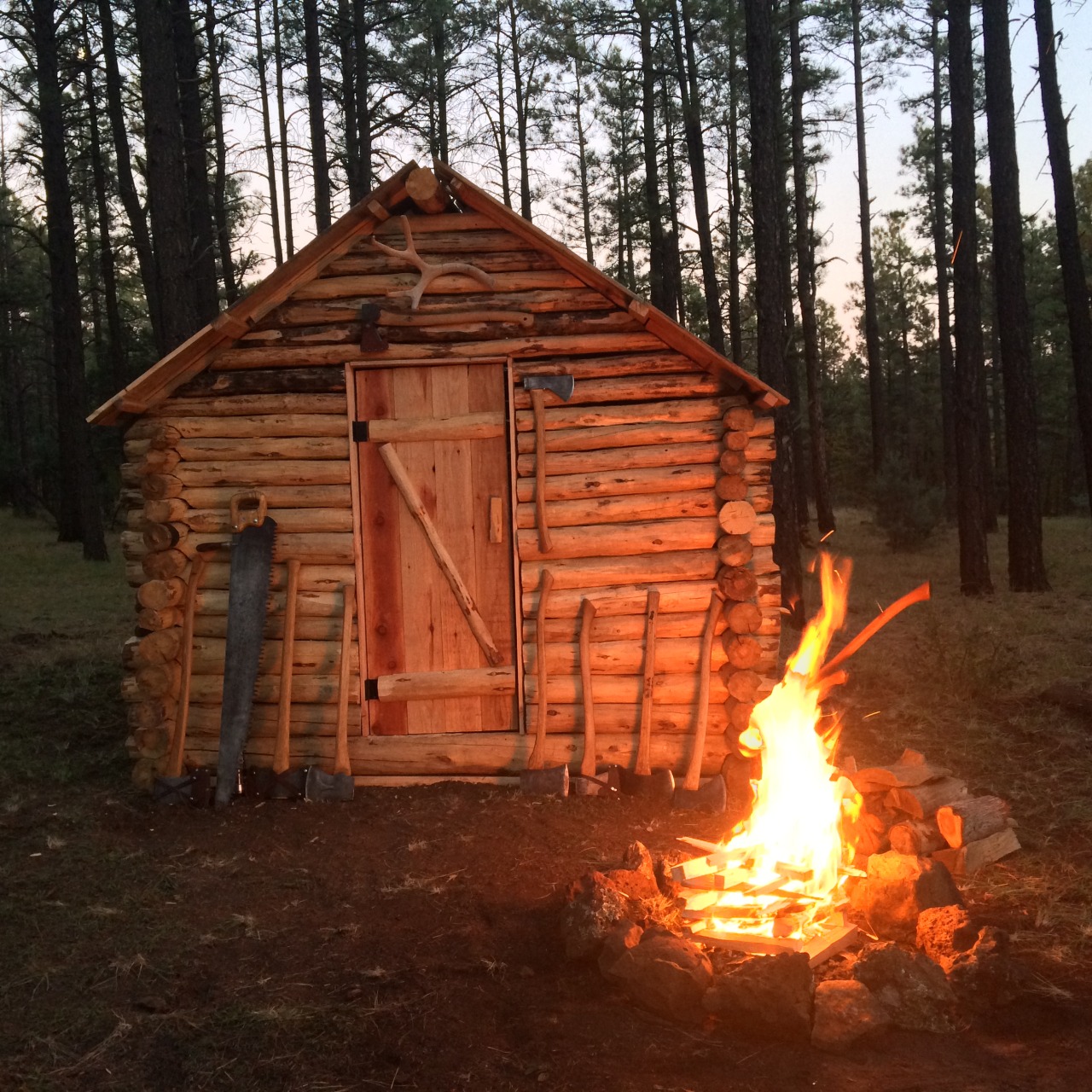

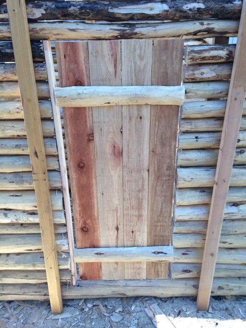

Mere side note in this, and not criticism of workmanship at all ('cause ya done a real fine job laddy!) but any diagonal brace across a plank door ought to aim at the bottom hinge; 'compression' fitting (to keep the door square while the wood expands/shrinks) on plank-made doors is more resistant to distortion than a 'tension' diagonal brace with it's origin at the top hinge. These age-old dictums are not taught in trade school anymore. And 'rustic' garden gate purchasers wouldn't appreciate quality if it came up and bit them.
Well done! I bet that was a blast.
Most common problem with home made gates and doors. 300Six is spot on here.
got a question: What would be the absolute minimum of hand tools only, to build a cabin like this. Like say, hiking 30 miles in, finding a suitable spot, forgetting the laws, and building it? Would love to know that. Could it be done with a 21 inch sven saw, a carpenter's axe, some wood files, and a draw knife?
