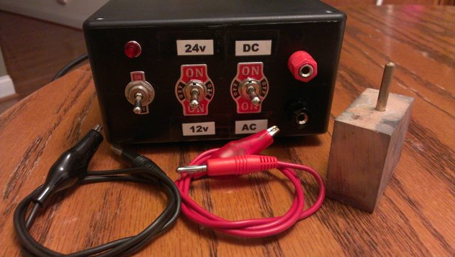

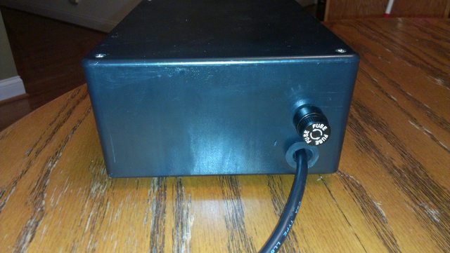

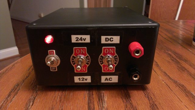

Well, I built a selectable voltage etcher. Do I need 24v - not sure yet, as I am new to this - but it was fun making it and playing around with it so far. Thanks to all the posts about this topic, and thanks to those who share your knowledge - it definitely helps us "newbies". Now it's time to dig up some information on etching different types of steel, etching times, etching solutions, etc..

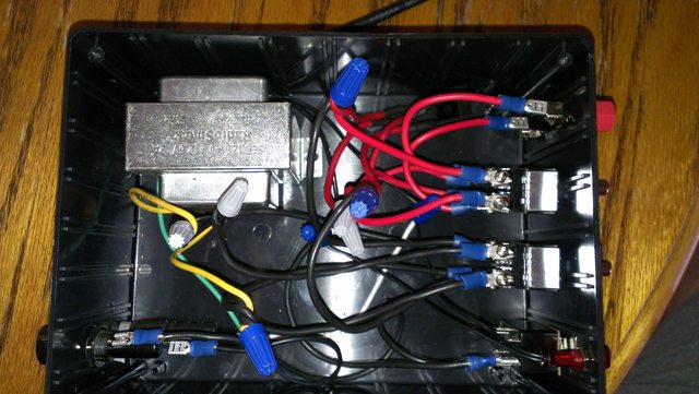

Do you have any pictures of the guts? I'm wanting to make one, but sadly I don't know much about electronics.

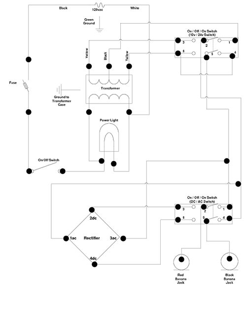

A schematic would be fun to see also. If you have one....................

Synthesis and Broomhead...here you go. I am no electrician or engineer so I am sure there are better ways to do this. Also, this diagram was done in a hurry so I hope I did not miss anything. All of the parts used are the same as the Chris Crawford model linked by 12345678910 with the addition of one extra DPDT switch (on-off-on). Any tip syou guys can pass along on the steels, time frames, etc. would be greatly appreciated.

Of course the Variac is AC, so is the transformer used in this project already! (Variac = Variable AC)
When you output through the bridge rectifier, you make DC.
So, variable DC.
The problem with trying to make an etcher/anodizer is that you can easily output 110VAC and hurt yourself. Likewise, if you forget and have it set to 110VDC when you try to etch, you're going to fry your stencils. The 1 amp circuit breakers don't pop because etching and anodizing require far less than 1 amp.
Secondly, you want a lot more filters in an anodizer than you need with an etcher. Ripple doesn't matter when etching, but it makes reproducing a color difficult when anodizing.
