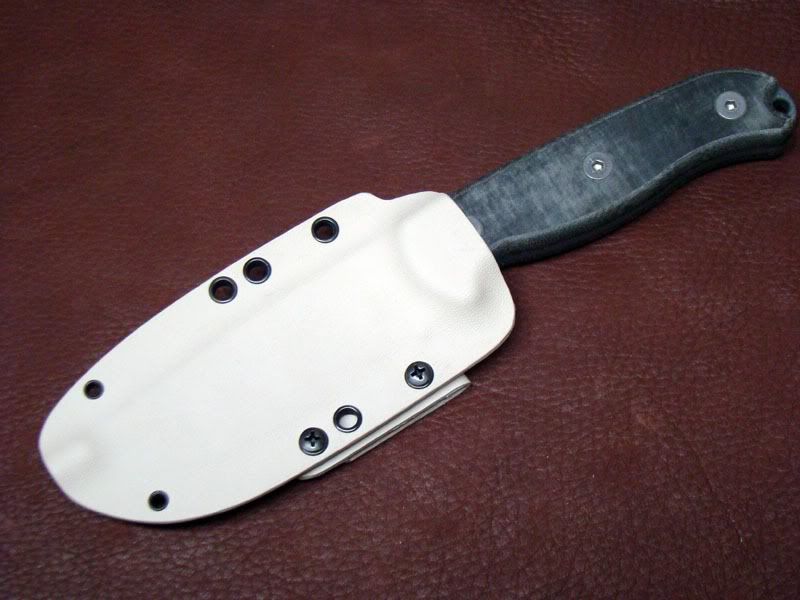

Bumble Bee knife
The bottom 2 are for neck carry. The top smaller one is what I call a "tuning" rivet. When there is little to grab hold of, such as the case of the Bumble Bee, the rivet acts as a means to hold the kydex together and keep it from separating so the knife stays tight in place. Nearly every single sheath I make has the 2 bottom ones...sometimes just for aesthetics. I have a Rat TAK that I did it on as well. I think it is safe to assume that you will not carry this knife as a necker, but it does look quite nice.:thumbup::thumbup:
This one is set up for both small and large TekLok carry as well as right/left, vertical and horizontal. Most of my sheaths are like this style.:thumbup::thumbup:
