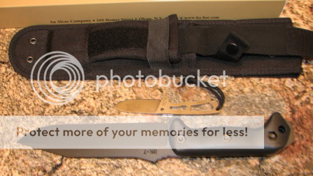

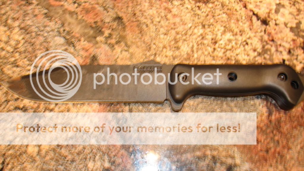

Finally my new BK7 arrived.. Upon inspection I was impressed with the overall condition of the knife, didn't think I'd like the thumb ramp jimping and had intended to take it off, but I actually like it.. Knife feels great in the hand..
So I decided to take it out in my back yard and get it a little dirty before I take it camping this weekend.. I did just a little batoning, then moved over to chopping (the media used was 1yr aged oak firewood) the 7 was doing really well considering its extremely hard wood and I've used other knives in comparison. I was working away on a 4" diameter when I noticed the middle screw was GONE !!!!.. I found the nut but the bolt is still MIA>... really bummed out as this knife is totally brand new, now I have to go hunting around for a screw to match those in the knife............. I've heard to use loc-tite on the bolts and intended to when I was done, I had no idea it would come loose so quick....... There should be a disclaimer about the screws coming loose in hard use.. I wasn't to impressed with the sharpness out of the box but I've also had other production knives twice the cost come about as sharp, so no worries.. seems some come sharper/duller since its production.. with that said, this sucker didn't loose the edge it had on it at all !!! NICE !! Cant wait to convex it, I've already put loctite on the remaining bolts.. so when I get another I'm good to go....

Eureka...was in the FAQ
Extremely popular question... From Toooj '''The Fasteners for the BK-2, 3, 7, 77, 9 are Socket Head Cap screws #10-24 x 5/8" L. The BK-11 Screws are #6-32 x 5/8" (Not positive on the length) Socket head Cap screws. You should be able to go to any hardware store and buy these'''

I found the screw.. I forgot I had a heavy magnet roller in the garage.. (thanks bladite)...
