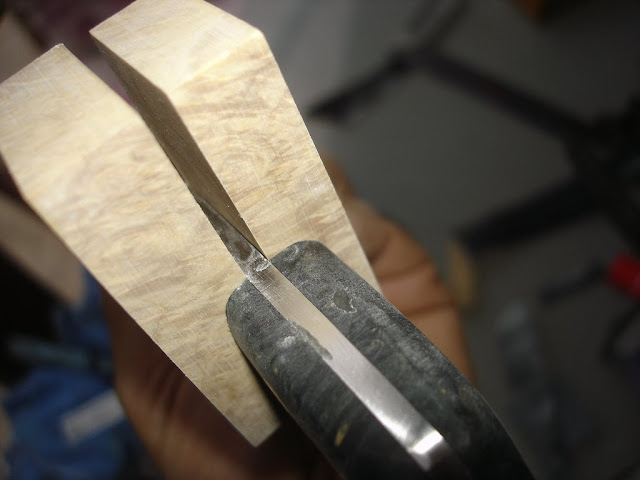

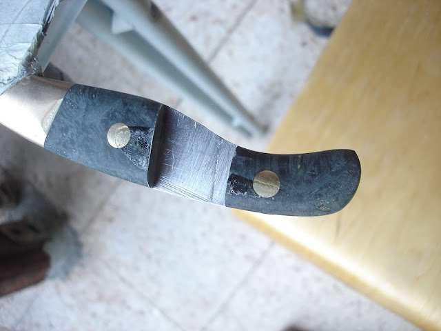

I nearly finished this knife, the handle material is black-stabilized box elder burl. But while hand sanding the handle a piece has came off :barf:..

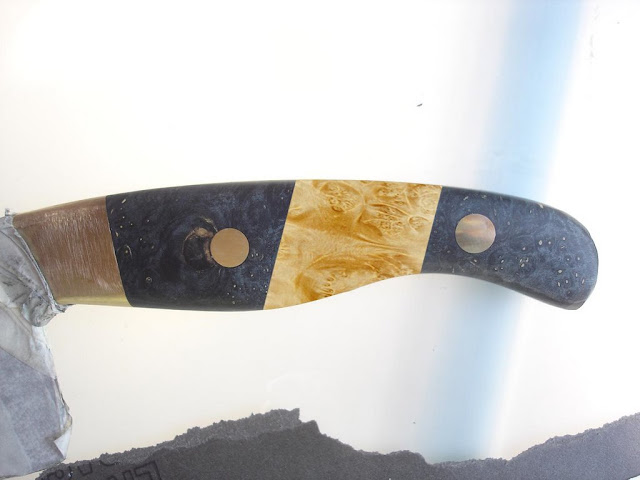

I was pretty discouraged at first. I tried to fill the void with some epoxy and sanding dust mix, but it turned out very ugly. I wasn't sure what to do. My gf did came up with a solution.
Before :
After:
Photoshop image, the plan is to fill the gap with a white-box elder:

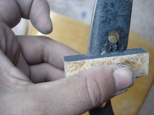

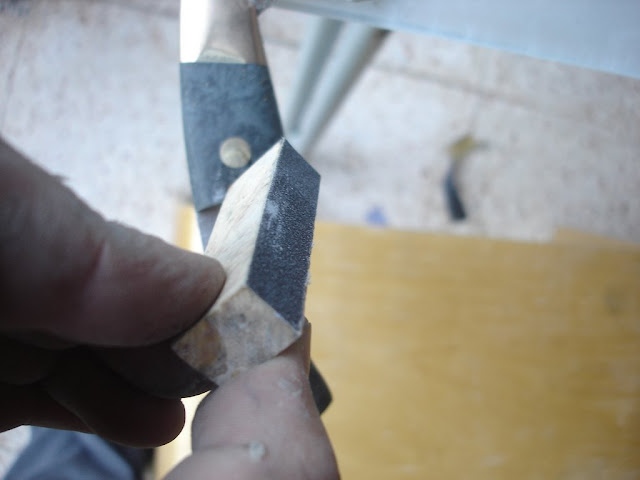

The hi-tech tool to square the edges of the gap:
Squaring things up:
I am done with one side, all will be finished by tomorrow evening I guess...

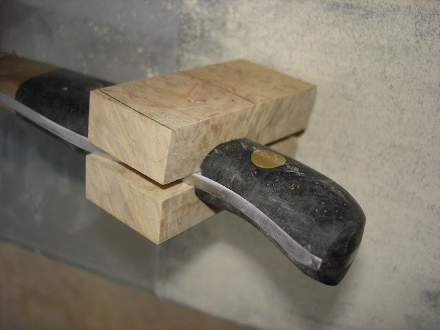

I've been working very carefuly, to make sure there is no gap between materials. Here is test fitting those stripes of white wood:

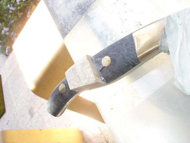

And after attaching and trimming (there are holes and dents under, so I guess little epoxy pins between black and white wood will be strong enough)

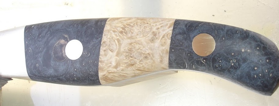

After sanding a bit:
