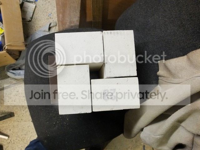

Yep, that's exactly how the Graham is laid out. Here is a more traditional 6 brick layout. Just grind/carve away to make the chamber roundish instead of rectangular, it'll make a big difference.
I've used a 4-brick arrangement before now:
There's obviously no centre to provide the pilot location for a holesaw so I used a piece of scrap wood, holesawed a hole in it, clamped it to the top of the bricks and used it as an external pilot to guide the holesaw for the first cut. After that, there was enough meat in the hole to keep it straight for the rest of the way. I used a standard holesaw, so had to go in steps of about 1 1/2" and break out the core each time the holesaw bottomed out, but it was pretty easy.
If you've got 6 bricks, it should work well as it leaves one for the front and one for the back that you can make smaller holes in to restrict the openings.
I pinned my bricks together with welding rod. I cut the rod with a pair of end-cutters to leave a a sort of blunt chisel point on the end, chucked it in a drill and drilled through the IFB with it, snipping off the ends of the rod once it was through. Primitive but effective.
