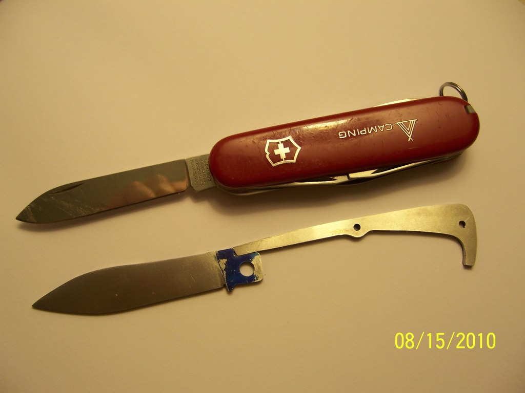

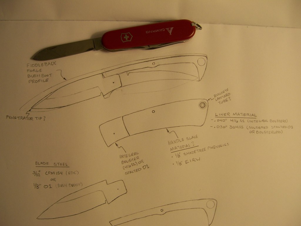

That being said, here is a picture of the main portion of the sketch. A standard Vic SAK included for scale. I don't know why I didn't keep the Bushboot out and include it in the pics:o The top view shows the basic outline of the Bushboot. The darker lines are that of the folder blade and spring layout. Note the substantial decrease in the guard required to convert it to a blade kick. The really faint lines represent the blade in the closed position. Also shown are each of the individual components, separated for clarity. Notebook paper was used to trace the top drawing, cut out and transferred down below. The notebook paper will likely be glued to the steel for profiling assuming no changes are made between now and then.

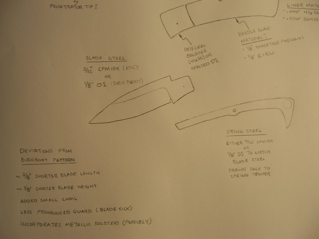

Here is another picture of the remainder, including some notes.
Honestly, I think this is a pretty good design, which isn't at all surprising since it is based on one of my all time favorites from Andy. It consumed my thoughts for the majority of the 4.5 hour drive back from the beach. The more I look at it, the more I want to get started. I know I need to finish up #1 first though.
I think the back portion of the spring needs some tweaking, especially if there is any hope of included a bullseye lanyard tube. Right now, I don't think there is sufficient meat left around the hole in the spring, the liners or the handle scales.
Alright, now that I've posted some pictures, lets see some comments/suggestions.
For grins, I'm also including some pics of Slip Joint #1 and the fixed blade I mentioned previously. Thanks for looking.
This one needs some additional work on the profile at the tip (presently too long to pull into the spring recess) and at the tang. After that it is time for heat treat.

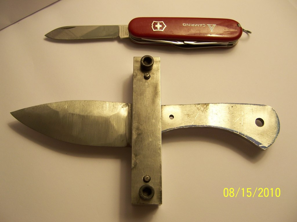

This shows the fixed blade blank with the file guide I made installed. I need to epoxy the solid carbide strips I bought to the faces of the file guide. After that, I'll finish up the plunge lines and begin hand sanding this one to clean it up a bit.

JC(!), those designs are EXCELLENT!:thumbup: Absolutely love the idea of a bushboot slipjoint. Personally, I'd prefer 3/32 CPM154 or some other stainless steel, since it's a folder.
Again, wonderful work mate.
JB, those designs are EXCELLENT!:thumbup: Absolutely love the idea of a bushboot slipjoint. Personally, I'd prefer 3/32 CPM154 or some other stainless steel, since it's a folder.

Thanks for the feedback. I love the idea too, so it is taking some serious will power to finish up the other one. I did get the scales for that one cut out today, so once I relieve the liners, it will be ready to fit together for the first time. I'll have a better idea once I temporarily pin it together, but it is looking like it might turn out halfway decent.
The first Bushboot slip joint will almost definitely be in 3/32 CPM154 since I have ~32" of it. We need to come up with a better name for it, Bushboot slip joint is just too much to say:eek:

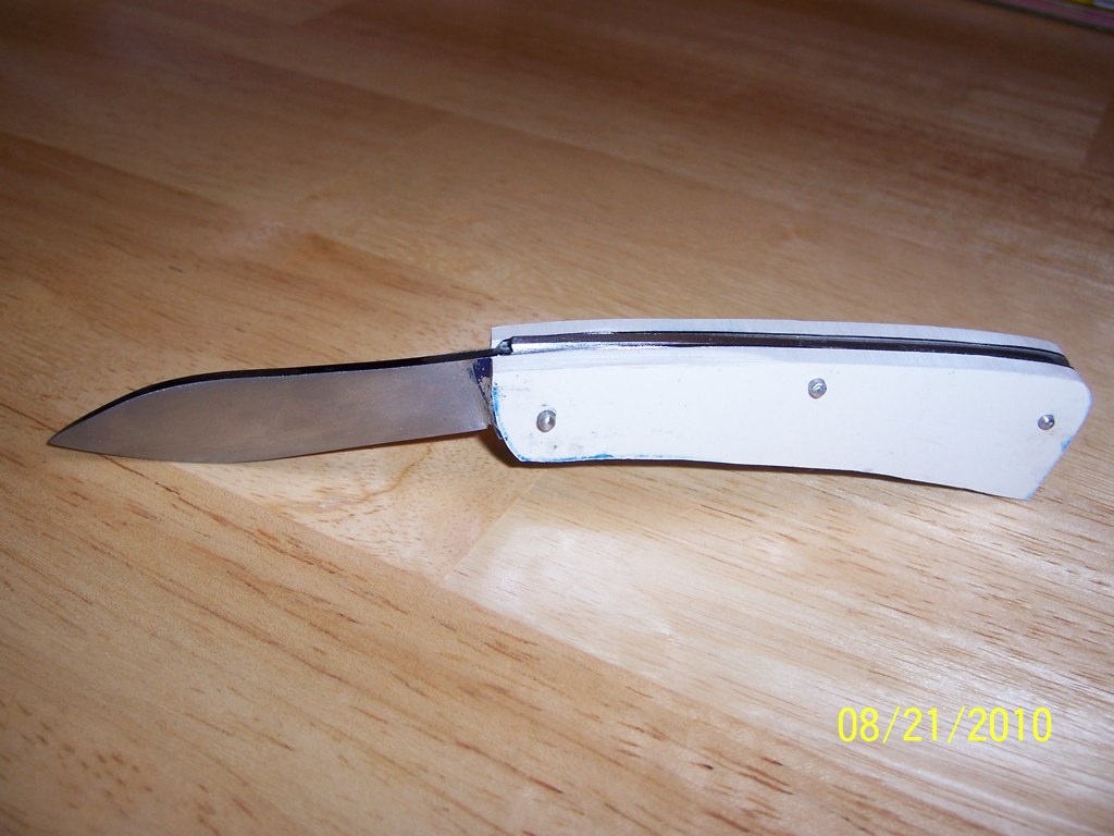

I made some more progress on my first slip joint this week. There are several actions remaining, but it is cool to see it finally taking shape. I cut out/rough profiled the liners, drilled the pivot, center pin and rear pin holes, relieved the area around the pivot hole, glued on the handle scales, drilled the handle scales and temporarily pinned everything together. I knew the blade was a bit too long to tuck into the handle appropriately. Now, I can see exactly how much and remove material from the blade accordingly. It also allows me to get a first impression of the fit between the tang and the spring. As you can see, lots of work to do here.
Overall view of the temporarily pinned knife. Still a lot of work to be done, but overall, I think it is looking pretty good, especially for #1. We'll see if that continues as work progresses.

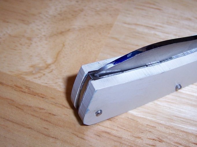

Detail view showing the tip of the blade hitting the tail end of the spring. Looks like about 3/32" to remove before it will clear like it should.

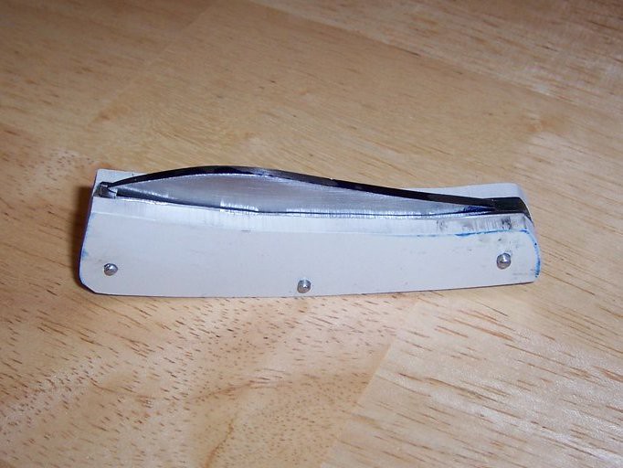

Overall view showing the blade approaching the open position. Additional material needs to be removed from the blade stop so that it will open fully and have a smooth transition to the top of the spring. I'll touch it up slightly now and do the bulk of the finishing after heat treat (i.e. when removing material is a slower process, so I'm less apt to screw it up).
