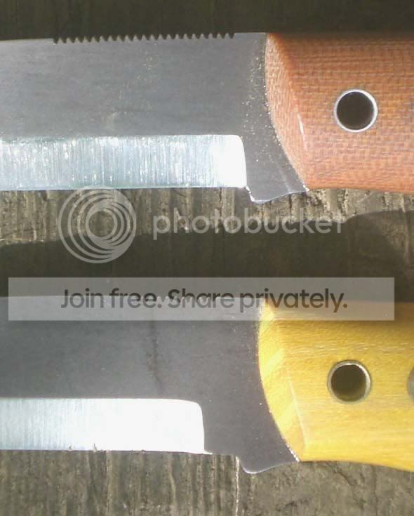

When I ordered it I assumed that the blade itself would be like the original but I later saw pics and then Dan confirmed he no longer was making the blades with the extended plunge line. When I got the blade I also noticed that the thumb grooves are about 1/3 the length of the original.
I'm not a thumb groove freak so that doesn't bother me. However if I was the grooves are not in the right place for my thumb on this one where on the original they were so extensive you could have had your thumb in a variety of positions and made contact with them.
However the lack of the extended plung line is a real let down for me. :rolleyes: It doesn't really affect cutting large stuff but when I was cutting stuff like half an inch or smaller I would almost always try to cut with the ricasso because the point where the knife contacts the wood naturally for me is there. Now for 99.9% of the people it's not going to make a difference. A lot of people like big choils anyway. But for me the original design is so superior for fine cutting.
My guess would be it is much faster to make a little thumb ramp and to make it with a big ricasso so at the level of production that Dan is running at the changes are almost a necessity.
Anyway here's a pic where I hope you can see the plunge line and thumb ramp difference.

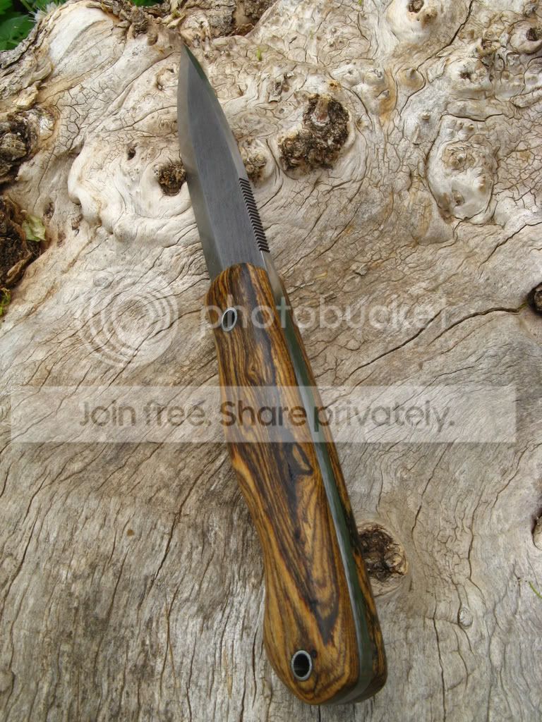

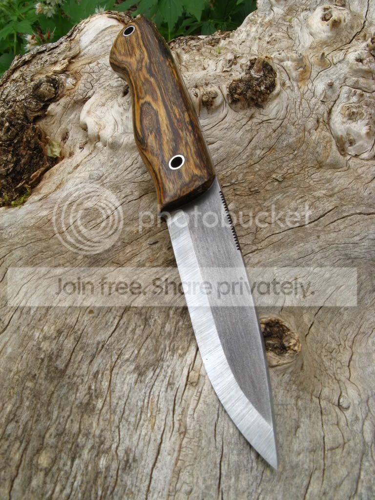

I finally got some handles on this one. I sold the blade itself and the buyer wanted a handle on it.
This blade shape and scandi grind just wasn't my style.
Excellent job Bruche!
Love the way you extended the handle up to cover the "bump"/guard ish part.
Curious, what didn't you like about the blade shape? I like it overall although if I had my druthers I'd like it to be thicker, spine to edge and with some belly. The skookum blade has that belly and it seems like it cuts a bit more efficiently in difft grips if you know what I mean.:confused:
Yeah the blade starts right at the end of the scales. I sanded off part of the bump a little bit.
I guess I prefer more of a drop point for a knife this size. I'm also addicted to convex edges.
The sheath for this one is almost done...it should turn out pretty good.

Wow!!!!!! Very nice work Bruche. You profiled the handle very well. I didn't pick up what wood you used? No matter, well done. :)
Bocote. The best looking stuff around! I'm partial, since I have 2 of his handled knives witht the stuff! :D:thumbup:

I have one of the first run Koster Bushcrafts and like it. I would not be happy with the plunge line on the new ones though. Why mess with success? Seems like a step backwards to me, at least for detail carving and notching.

It may be picky but, even if it is the best deal going on a Bushcraft, I don't want to decide to buy TWO of something based on what I see in the first run only to wait several months to find out such a key (in my book) feature, such as where the blade starts, is changed. I hit Dan up about it and he said he likes the new way better but would do mine the "old way." I use that part of the blade and it drives me nuts when I get one and it's not ground there or, is almost finished being ground there. I have had several where they were not finished being ground to an edge for as much as half an inch and they either get moved or get fixed.

The thumbgrooves are shorter simply because they are a bear to put in. :D It is placed further out based on the feedback I received that most found they didn't need it as a thumb-stop...but it was more useful for firestarting. Also, that after hours of carving...thumbgrooves that were too close (and a spine too squared off) wore out fingers too quickly. So, the spine is rounded between the handle and grooves for comfort...and the grooves are there for an extended thumb stop..but most for firesteel striking.
The edge on yours wasn't polished on purpose to facilitate you working on the handles...no sense in slicing off fingers...I figured you could finish out the sharpening.
The ricasso is a weird thing for me...I didn't like it going all the way back on the first run...very hard for me to finish out properly...so I moved it up on the next batch. I was supposed to move them all closer to the guard when I did post-heat-treat grinding and simply forgot. You guys reminded me in a post on my forum...and I appreciated it. Can't do anything about what's already been glued up...(blades have to be fully ground before glue-up...hard to explain why)
So, I did the best I could with the next batch that I glued up this morning:
http://www.bladeforums.com/forums/showthread.php?t=555543
(the bevel has a funny reflection on it...but be assured..it is indeed flat)
The edge is ground back as far as I would like to take it (about 1/16" - or less - in front of the guard). I think, with time and many sharpenings, the reasoning behind the change will become more evident.
