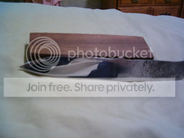

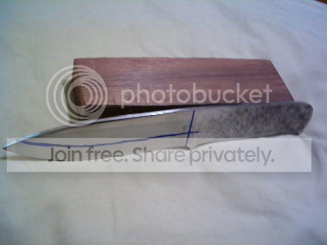

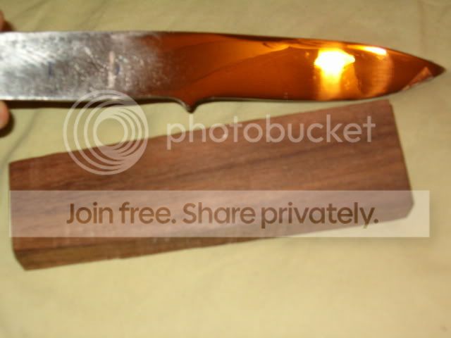

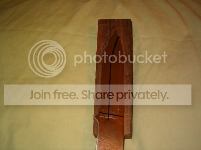

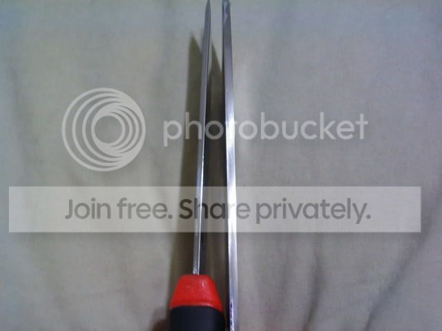

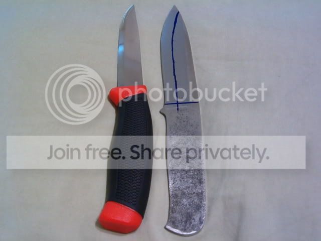

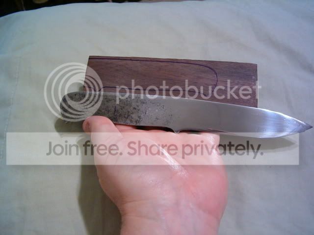

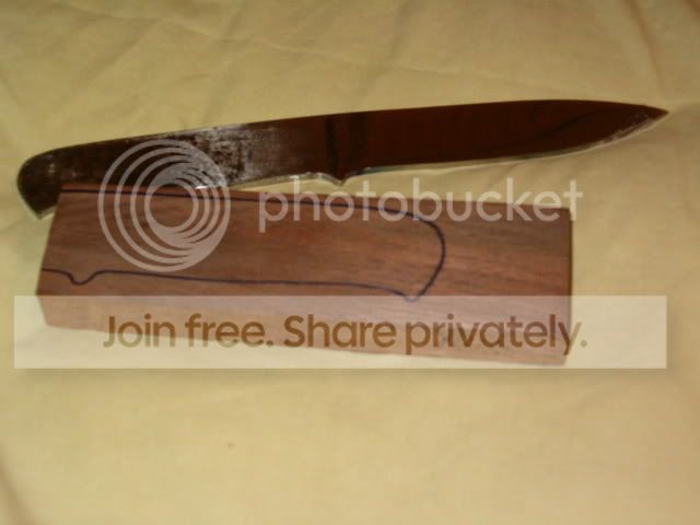

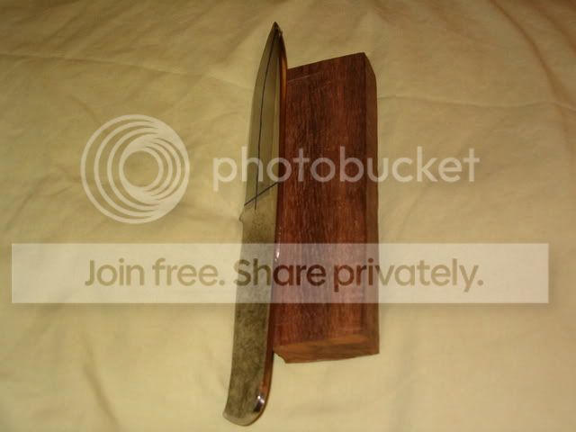

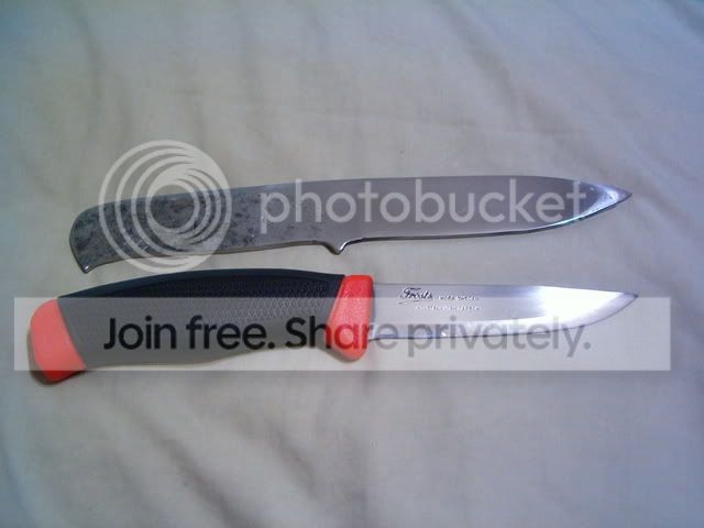

Same steel as my little skinner, gonna wear walnut scales, and have a scandi grind. It has an OAL of 8 1/2", blade length of 4 1/4" and blade is about 1" edge to spine at its widest point, and a bit over 1/8" thick. I included some shots of the handle material block, and some with a Frosts Clipper for proportion.
It is still pretty rough, and needs more finish work of course. I will post progress as it happens. Feedback & helpful critiques welcome.

Very nice! I like the spearpoint too! Will you skeletonize the handle any or leave it like it is?

Funny you should ask. I have been sitting around tonight getting a feel for the balance and weight to make a decision about that. The blank as is, balances right at the front guard, so I will probably take some out between the pins. I also fought with it trying to mark my pin holes, the arcs along the top and bottom of the handle make measuring for holes an interesting task. I have some 1/8 brass rod, but think maybe a larger size pin would have a better look, and maybe swap the rear pin for a brass lanyard tube. Still up in the air, who knows?
