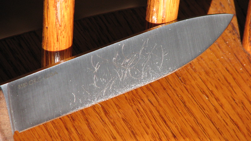

The blade is long and straight. With a drop point, typical of a Bushcraft knife. It is marked Bushcraft on the left side. And 5160 OKC-USA on the right side.
The grinds are uniform and equal on both sides. Except for the very tip of the right hand side. It looks like someone came off the belt just a tad early. Probably not wanting to dull the tip excessively. We are talking somewhere between a sixteenth and a thirty-second here. Most likely five minutes work with a stone. There is just a little extra metal at the very tip.

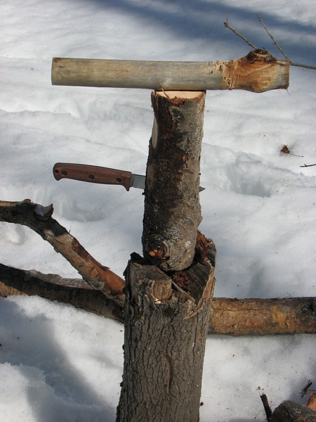

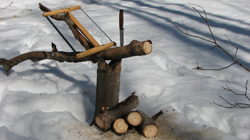

First saw up some downed poplar,

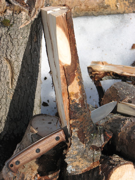

Then have a go at batoning, poplar splits harder than one might imagine. I guess being such a soft wood. It gives rather than splitting. But we had no problems reducing it to a more burnable size.
I even beat it through a few tougher pieces.

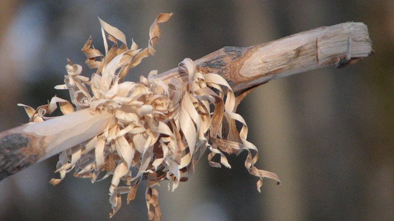

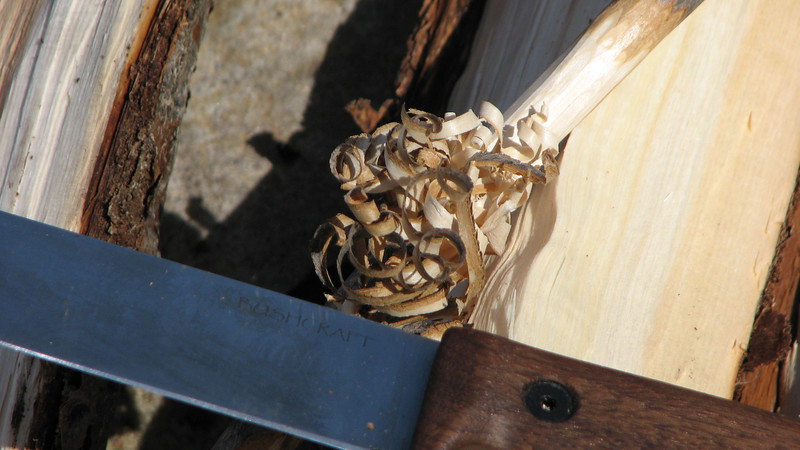

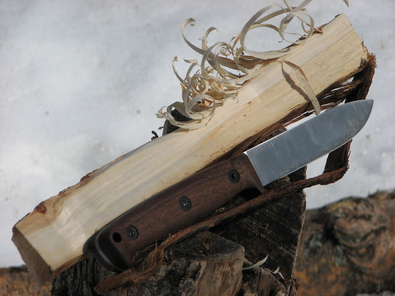

Playing around with the first feather stick attempt,
I thought the handles took the Walnut Oil and bees wax well,

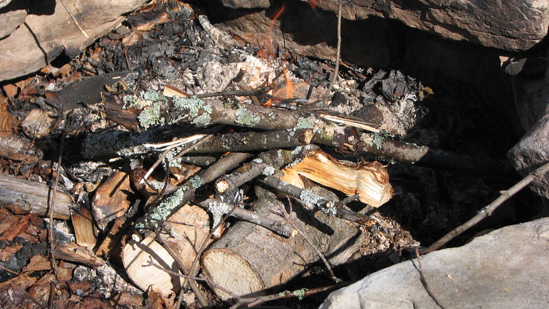

I hauled it all over to the fire pit I dug out last night, and built the worlds ugliest fire,

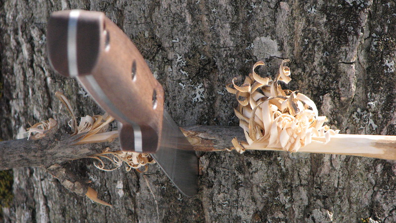

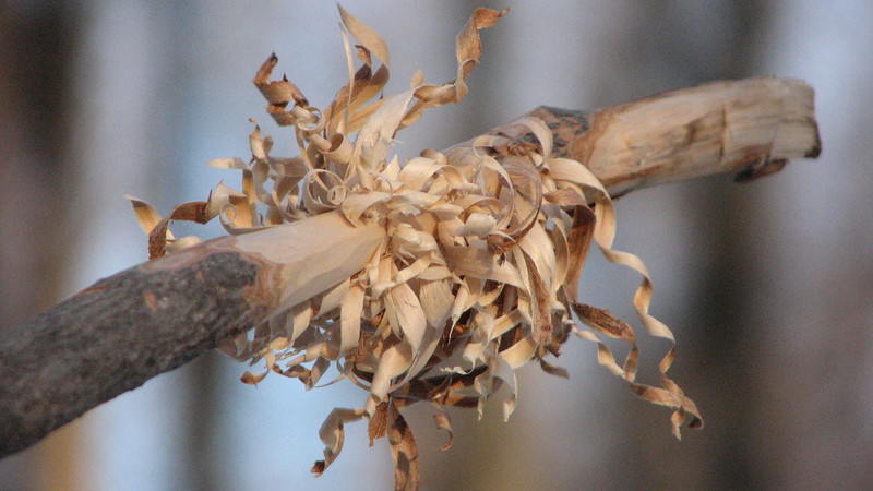

Working on the Fuzzle Berry sticks,

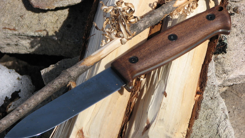

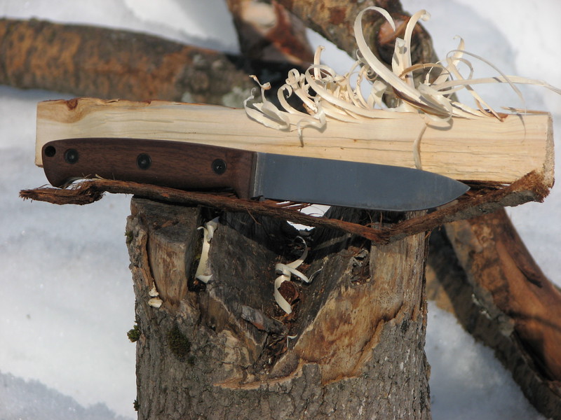

Not too shabby! Again we are working with the factory edge here,

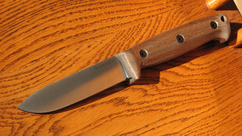

One last shot of what is looking like a very capable knife,

Well, I went back out after dinner and played around a bit more. Now I am certain. Ontario has hired that Witch Doctor from Helsinki.
There is no way you can get these Fuzzle Berries without a Sandi-Fluvien Grind. And they are the only ones that can do it.
