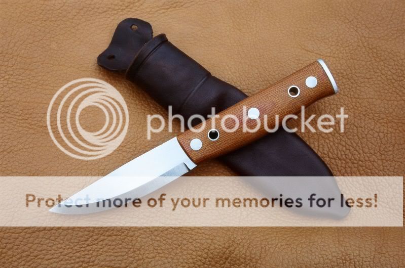

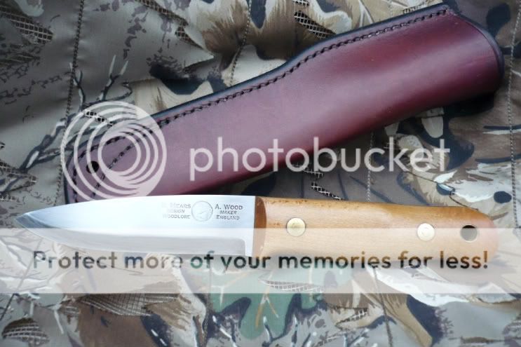

These are examples of “Bushcraft” Knives...certainly not the only knives for bushcraft activities.
Woodlore
BCNW-01

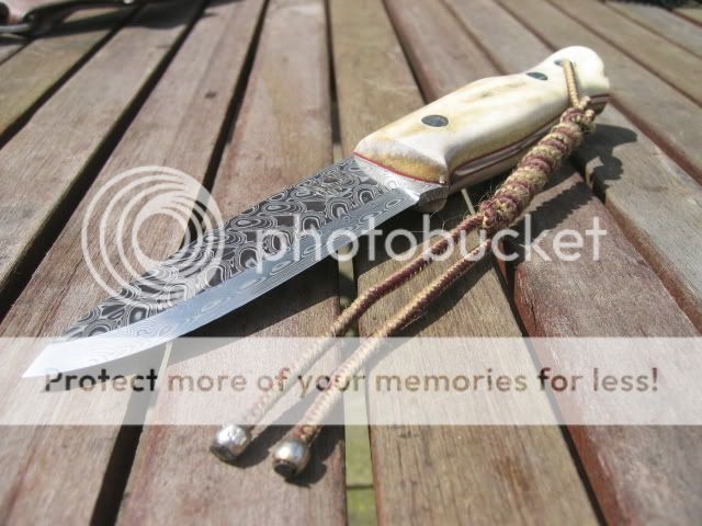

Skookum Bush Tool
This one is not a “Bushcraft Knife” in style but perfectly capable of doing the same things.
A comparison. A knife for bushcraft is not necessarily a “Bushcraft Knife” ...
