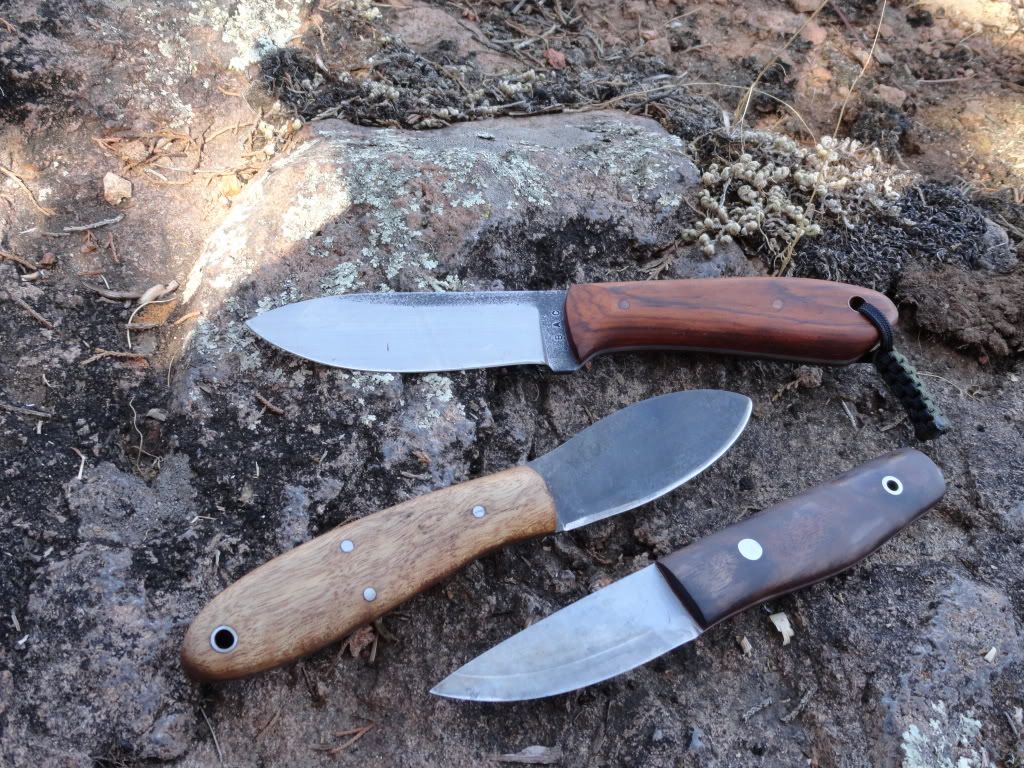

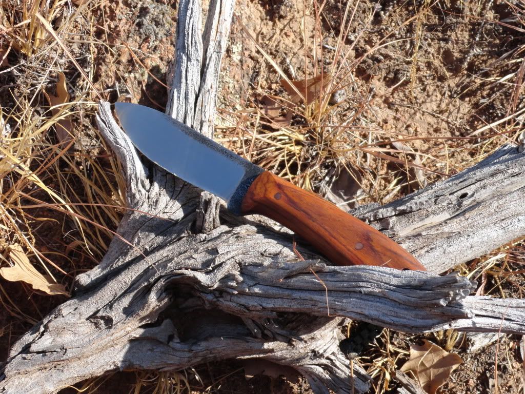

If it helps the pics below are of Bruce Culberson's knife that won.
