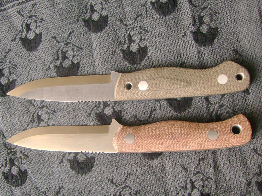

As I stated in the order thread I received my Bushcraft Knife today and could not believe how different it feels in hand. I think one of the most asked for changes I heard about concerning the older generations was for thicker, more hand filling scales and the gen 3 knife sure delivers. I had no issues or problems with my older bushcraft but from a first impression standpoint the new handles appear to address these concerns. I would have to give the knife a good workout to check for hot spots and such but at first glance everything appears comfortable and the knife seem to "lock into" my hand much better. I think this is due to hump on the old handle being moved from before the lanyard hole to behind the lanyard hole on the new model. It seems make the handle feel longer in the hand without adding much if any length. Also the guard is more pronounced as well. Here is a couple handle length shots maybe you can tell what I'm talking about. Old school on top, Gen3 on the bottom.

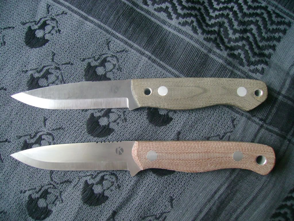

Here is a shot of the handle guard. Slightly more protruding. I know some dislike any kind of finger guard on a bushcraft styled knife. Personally I don't mind them on mine.
Gen3 on the left, Old School on the right.

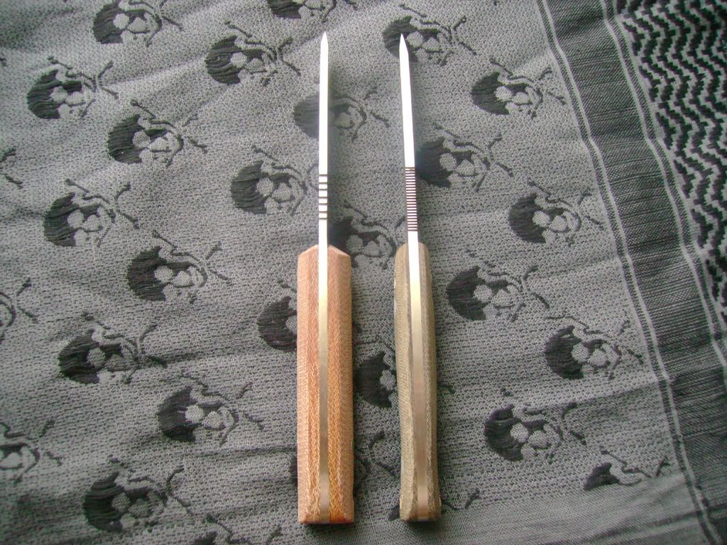

The handle thickness seems to be a major change in this generation. I think a lot of people will like this. As I said earlier I have had no problems with the thinner handles on Dan's older bushcrafters so I'll reserve judgment on how well these new one's work until I've taken it outdoors a bit. Here is a shot of the comparative thicknesses.
Gen3 on the left, Old school on the right.

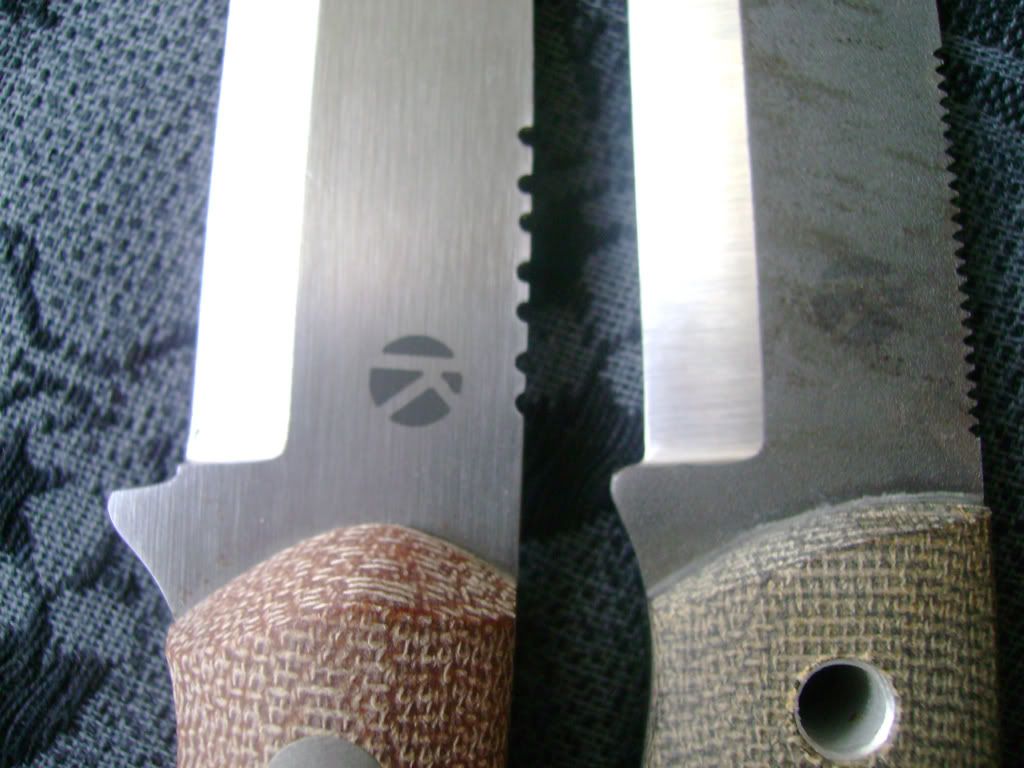

The only other differences I can notice off the bat is the blade finish and style of thumb jimping. The thumb rest seems to be just as functional on the Gen3 as the old model. I think I like the look of the older jimping better but honestly it's probably just because I'm so used to it.
As far a the finish... I'm still up in the air. My older model had the "as forged" finish and with the exception of the blade finish seeming to load up with wood goop (baton through some wood and you'll know what I mean) I had no issues with it. Both knives I have are CPM3V and I'm wondering if the new knife will be as corrosion resistant as the old one. I had ZERO rust issues with my older bushcrafter and I really abused it. If the Gen3 is as corrosion resistant as the older one then I think the new one is much better looking (Shiny = Bling).

Thanks for the review gmarthur. Looks like those G3 handles will really work well with my big mitts! Hopefully I can get mine before my last summer camping trip in two weeks.:)
I like the looks of the new one more, especially bigger integral hilt, and the bigger handles.

I like the original better. I like the arch along the back. I like less guard.
I like the more traction grooves.
The first one I got had a handle that was too thin too but Dan let me send it back and then he sent me one with 3/8" scales glued on so I could shape it myself. I really like it.
The newer model looks easier to make quickly but I like style of the older one
Are the new ones G3 or G4? Also the first comparison looks like a new one (G3 or G4) compared to a G1. The last run had a thicker handle and a larger guard as well.
Also, the new one lacks of a forward lanyard tube and has a larger back lanyard tube. The guard seems to sweep forward more than the last run.
I didn't realize that the new run wouldn't have the same contours as the previous ones. That was a feature that I really liked and I wonder how these will feel.

Regarding contours: I think you'll find you like it better without them. This was hard for me to believe at first....since I absolutely love to shape out a good palm swell...but I have found that the wider area in the back (where the "dip" in the contouring would be) is where most people were developing "hot spots". So, that had to go. I took it out and the reviews have been very positive. I think you'll find that you are still able to lock it into your hand, since the handle does have palm swell in the tang (vertical dimension).
G4 - there is no G4 actually...it only existed on paper.....it is now called the 2009 Bushcraft. And the design is based on tons of feedback I have received from you guys, as well as other buyers/users. I couldn't do it without you!
The forward lanyard tube was a great idea that really never saw its potential. I didn't know anybody that used it as intended, and my only use was to have it as a place to "lock" the knife in a kydex sheath. I've solved the kydex issue now with a larger guard (helps to snap it in place). It didn't really save me any time or money (the cost is very low) to remove it either. But since I was using 5/16" diameter lanyards on this run (to better match the 5/16" diameter corby pin heads)...it made a better visual statement to have the front lanyard removed. Further, I did not really do many wood-handled G1 bushcrafts...and now with wood as an option...the fewer holes I drill, the stronger the handle.

I like the look of the new model with a few caveats. Several pics I've seen of the newer Bushcraft show the plunge line of the primary grind not quite lining up with the forward side of the guard. You can see it in the third pic from the top here. And I agree about the size of the guard. I just don't need it for the typical use I put my knives to.
Other than that, it looks like a nice evolution to a wonderful knife.
The nice thing about a larger guard is that you can remove material to your liking.
