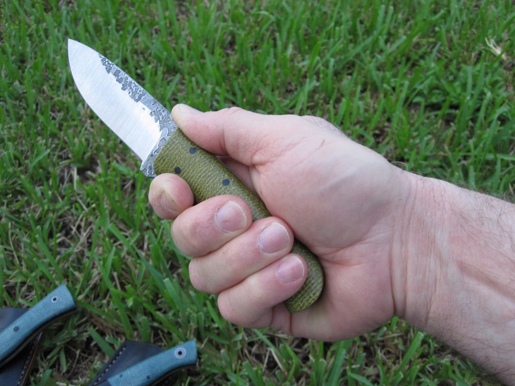

My BC Jr seems to have the same handle length as my HB with a similar rounded end, but a little more width in the handle and blade, drop point instead of a spear point, and about 1/4" longer. Here's an in hand shot, and the only comp pic I could find.
PS: If you zoom in you'll notice a spider on the Camp knife blade, it was purely accidental and I didn't even notice it when I was taking the pic. :D

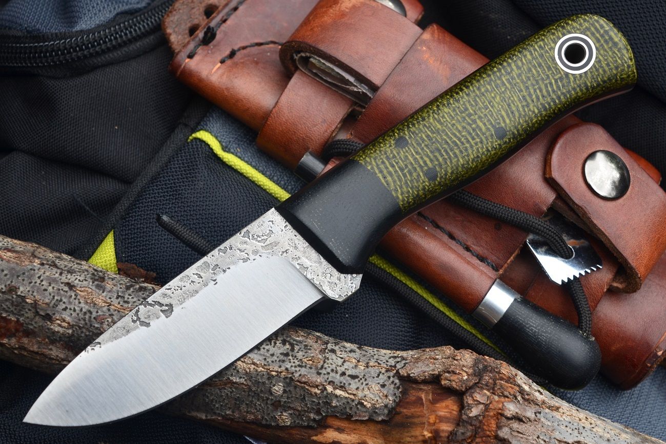

Excellent! The BC Jr is the wide blade iteration of a length ratio that I use a lot. The Hiking Buddy, Bushboot, Handyman, BC Jr, Bushnub, Bearcub, F2, Tobogan, Wasp, Shank, EDC, Rebel, Wingman, Patch Knife, and the Bushraptor all have 3.25" blade and 4" handle. Though, the blade is a half inch longer on the Bushraptor. I think for a small knife its an ideal size. Its a critical knife length in the lineup. The other part of my lineup that is as well rounded is the 4" blade 4.5" handle sized knives. I make a bunch of those too.
The spider is awesome!
