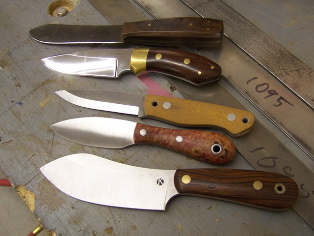

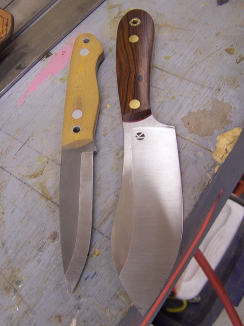

Well, its raining like hell outside today, and we need it so bad I can't complain. Plus, work and all that jazz too. But I did get some pics of my Koster Bushcraft. And along with that some other Gemz too.;):thumbup:
As with all knives from Dan, this one came sharp as hell. Its got some really pretty curves too. Its a great knife!

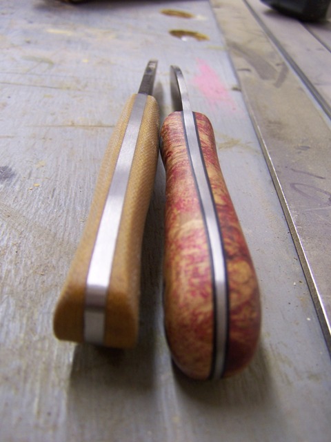

Dan, how do you get the mikarta to be scratch free, and yet still rough???

I take the micarta to 120 grit, then bead-blast with silica carbide (not glass, not alum. oxide). You have to cover the blade with tape to protect it during bead-blasting. Then, afterwards, I go around the edges wtih a 400 grit belt. :thumbup:

Gah! I love the looks of that Nessie! (Bushcraft is a smart-looking knife too!)
**EDIT: I was referring specifically to the nessie in the first post, top photo. But frankly all the knives look great!**
Fiddleback - can you give us some details on the leaf-shaped blade you posed with the bushcraft? One of yours? Natural handle or one of the burl-like custom synthetics?

Oh. Thanks y'all. The handle on that EDC is stabalized dyed Maple burl its got black liners and Corby bolts with a steel lanyard tube. They're all 01 tool steel.
