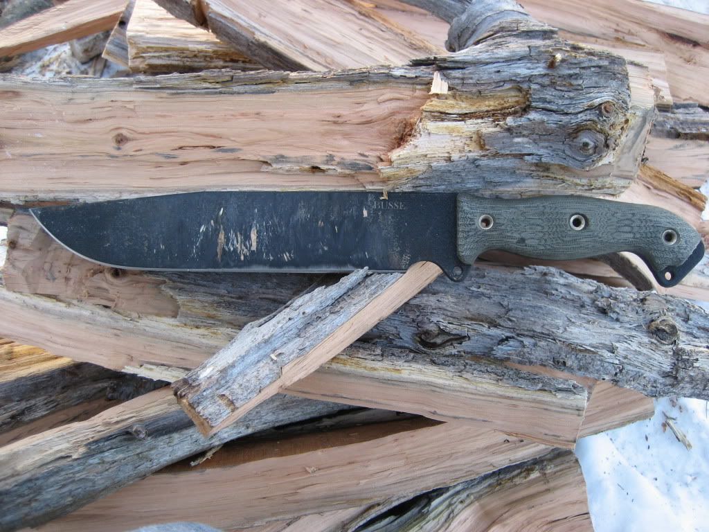

BWM balance point with heavier G10...
... compared to B11 balance point.
Only (non res-c) options that feel better (to me) than the BWM in hand is the Test Team KZ handle (super heavy though) or the forthcoming NMSHBM (a tad lighter).

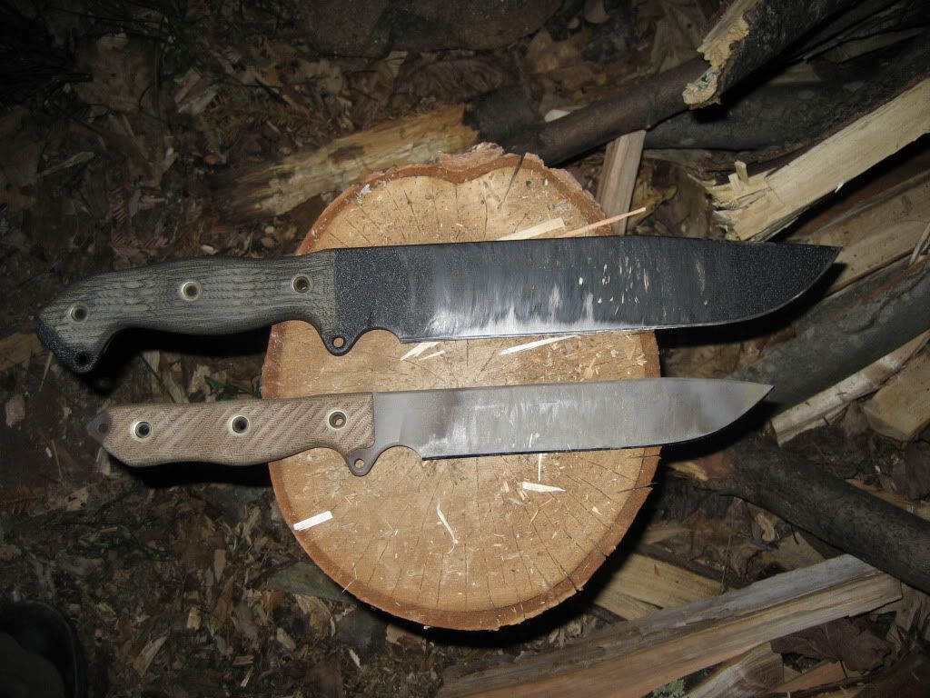

I will say that the first batch of BWM's are among some of the toughest INFI I have beaten on. That pumpkin is the only blade that holds up as well as my FBM LE under tough love conditions. Funny, they are right next to each other in this pic for that matter too. :p
Nice pics. Now that I was fortunate to get a team gemini coming my way how about the handle. Bmw handle vs. sar handle vs. team gemini handle. I have owned neither of these models and I am interested in the differences.
