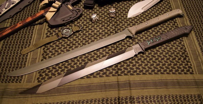

A few pics for quiet contemplation.
This one is not mine -- it is Tedwca's. I share it to show you a 'Banned' blade:
