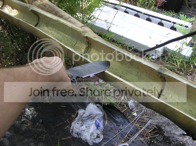

Now, I have a small nursery and decided that I needed an orchid hutch in order to grow my orchids as well as my limited funds would allow. Having a good supply of freshly harvested bamboo I decided to make it using the materials at hand, some paracord and my Natural Outlaw. Other than a wooden mallet, that is all the tools that were used.
In the above photo you can see some of the bamboo that I split in the making of this hutch. To the left is a trough that held water that potted orchids could sit above to keep the humidity slightly higher than it would have been otherwise. Center are strips that were cut to add rigidity to the structure.
Now, I realize that an orchid hutch is not truly survival oriented but it is applicable, imo. For a survival shelter I would have made it shorter than the sloped 7 to 8 feet this hutch was and I would have thatched the roof (using palm fronds down here in South Florida) and sides instead of using shade cloth.
Anyway, I hammered the NO through at least 60 linear feet of bamboo. It, excepting one other Busse blade I own, are the only knives I have that I would feel comfortable batoning with as I did, alternatingly batoning near the tip of the blade and near the handle. Of course, there are other knives that this could be accomplished with but none that I own that are robust enough to handle the level of hard use I put this one through. That is not to say that they don't exist, just that I am not aware of them. I believe that this is an important feature in a survival blade as, in stressful situations, even an accomplished outdoorsman may find himself doing things that can only be termed, in polite company, as a poor choice.
Anyway, I had been clearing out some brazillian pepper and florida holly (a misnomer, it is not native and both are highly invasive down here) before doing this and the knife was no longer shaving sharp. After splitting the bamboo the edge on the NO was now able to shave arm hair with ease, something that highly impressed me. In analyzing this, I can only assume that a combination of the way bamboo is structured and the unique (to me at least) malleabilty of INFI caused it to sharpen up as I hammered it through the material.

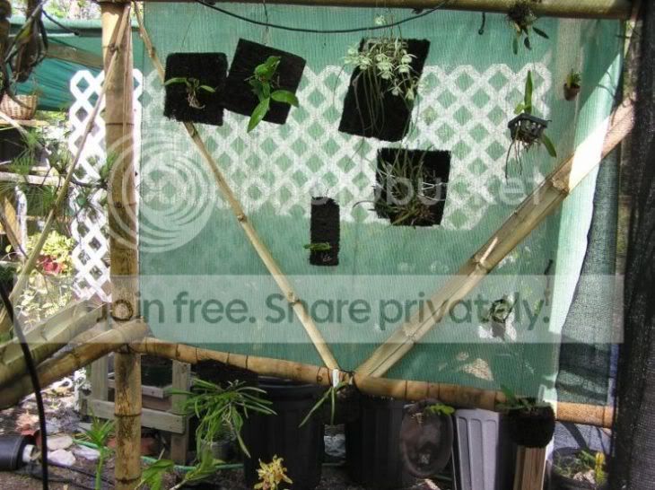

Now just to show that I am not (too ;) ) biased I will say this. In the wilds, I would have used thin strips of bamboo fibers woven together to lash the hutch together rather than waste precious paracord to do the same. The NO, due to its size and edge geometry, would not be the best knife for this task. For that I would prefer a thinner blade along the lines of the Mora or, my first choice, my trusty old Blackjack Trailguide. I do think that the NO could handle the task but, much like using the Mora or Trailguide to split the bamboo, it would not be optimal, to say the least.

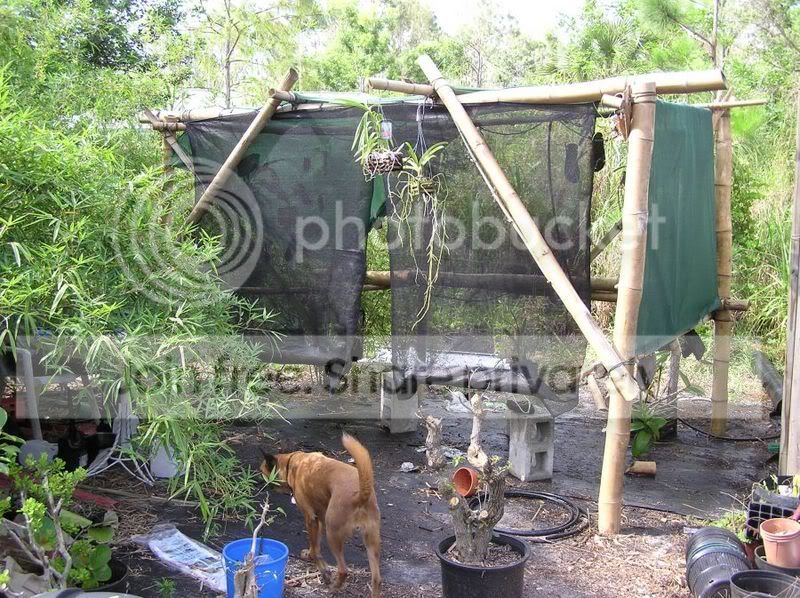

And the final product. I ran out of bamboo and had to finish off the cantilevers using some scrap 1x2"s that were laying around. This photo was taken several years ago after one hurricane (I forget which one!) had come through. Sadly, the hutch did not survive a second hurricane just weeks later.
