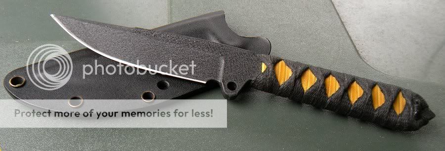

Busse Cord Wrapped Handles
very nicely done:thumbup:, that has to feel great in the hand. also, about how long did that take ya?
about 3 hours total. I'm not really good at high curvature items, or tapers. Theres a lot of craftsmenship/foresight involved in getting the weave correct when you need to reduce one end or the other.

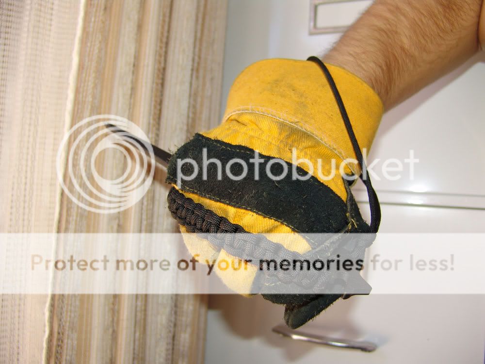

I had totally forgotten I did an ice pick like this....
bannister bar (100% for looks, not safe for actual use)

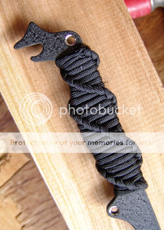

I should have removed the internal strands for this... as it was it was kinds bumpy. I'm still kinda disappointed in how the larger pbf's turned out. I couldn't get the twists out during the tightening process. In this pic the weave doesn't look that tight, but it's hard as a rock.

ok that n.i.p. kick's arse. the kydex is nice too, now i'm gonna have to do something similar to mine.
what was the count on your turk's head?
I don't actually know what count means in regards to knots :(
to be honest I don't know anything about knot tying. I learned just enough to do the turks head (almost) correctly for handle making. I never tried the double or tripple version of it since this was always sufficient for what I wanted.
It was about 7 up/down sequences, with about 4 full spiral points on one side for the shorter nip. I think it was 5 for the longer nip wrap.
that's what i wanted to know thank ya.
don't be so hard on yourself, the pbf has a nice pinecone look to it.

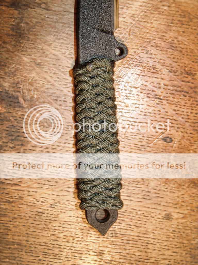

Not a Busse but a Swamp Rat at least.
I tried another wrap previosly but I'm to embarresed to show it.
On this one I used Loctite 495 glue IIRC to secure the beginning and end for extra protection against unraveling. So far it hasn't slipped but then again I use it for normal camp chores that a knife of this size would be used for.
Last visible canary, how do you get the end of your cord wrap to be completely flat without a knot sticking out of the end of the handle?
By melting the end of the paracord. Because the weave is pliars tight, it grips the paracord against the tang of the knife at the end of the knot pretty securely as it is, when you melt the last piece if creates a ball of melted nylon that is thicker than the rest of the cord, effectively blocking it from slipping under the last bight. you can smooth the melted cord with your finger while its still soft from the melting to keep any sharp edges parallel with the tang.
If your careful, you can also fuse the last working end into the surrounding weave, since it's all the same meltable nylon. You have to be careful doing that, because the melt can get away from you and end up destroying a bight right in the middle of a 20' paracord weave, the only fix for which is either trying to continue melt/fusing the severed bight into the rest of the weave, or disassembling and redoing the whole thing.
