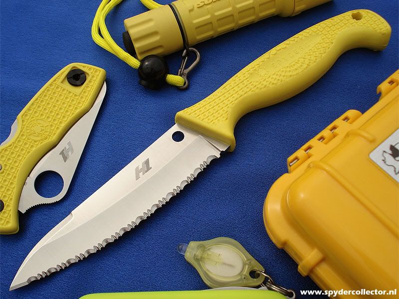

this would do the trick and cannot rust.

Diving knives using titanium are IMO only really needed for EOD use where anti-magnetic issues make them a neccessity. H1 may well be rust proof but how does it work as a pry bar ? Ditto Titanium ?

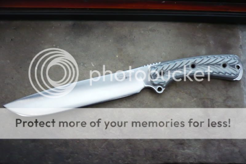

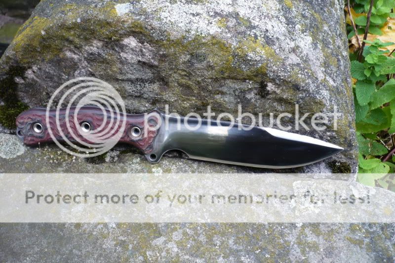

I like to use my SAR 8 for diving or my Satin Jack serrated clip point in kydex with two tek locks mounted on the sheath and altered to take the rubber diving leg straps. I also use an elaticated lanyard for each knife and secure these at the pommel. These accessories are easily available from any dive shop. I mount the Tek locks outside the sheath ( ie sheath close to the body ) which gives a tight fit.
On the issue of serrations on the blade as opposed to a normal edge ... I find cutting with serrations under water often needs two hands ... one to hold the rope and the other to cut. If however your hand is caught in a net cutting one handed and away from the trapped limb I find the normal edge slides easier and cuts easier. The serrations are better for catching fishing line and smaller stuff ... but as said for this stuff I much prefer shears. You do need a bit longer normal edge though compared to a serrated edge to cut in one slice on the heavy nylon rot proof rope but a good edge can still do the job fine. Each to their own though on that side of things ... but the normal edge is a lot better for shore based emergency/survival use.
Hey Peter, thanks for the post. And of course you post my grail knife!! Yours even have jimping unlike the others that have come out...
I'm guessing I will wait at least a few years until either a SFNO or SAR8 come out with all the bells and whistles.

good post though. Out this way we get a few whale rescues from nets. I plan to be prepared for that case as I have a place on the water and I would likely get a call when the crew gets together for a rescue. With that said I would want a knife/hook that can slide between the netting and the skin of the whale/seal/dolphin without hurting it. Also I would like to move fast so a double edged knife is out. But that looks great as a standard dive knife. The spyderco setup is probably as good as it gets. I think a seatbelt style rescue tool would be good for the net work.
