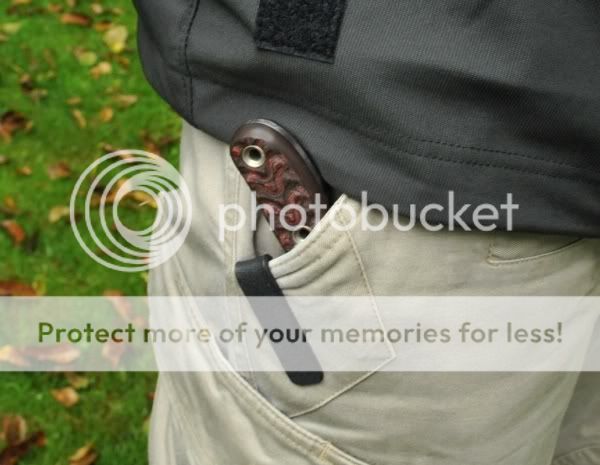

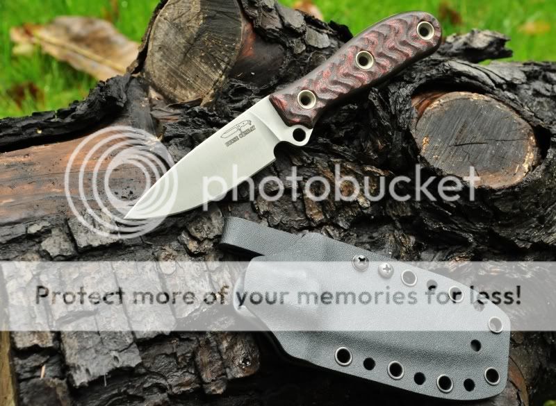

Well... Game Warden and Active Duty are two of my favorite EDC sized Busse blades. So I decided to have some fun and make "my ultimate Bussed EDC", which would be AD blade (full flat grind) and GW handle profile. So I took AD and reground the handle to GW shape. And that's the effect:

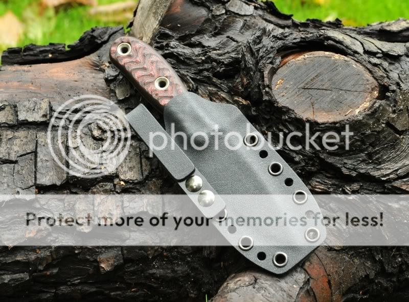

And than I thought that "pocket carry" would be the way to go. So I made a sheath (that can accept almost any carry system BTW) and made "deep pocket clip" out of 0.125" kydex. That extra thickness of .125 kydex gives enough strenght to ensure safe carry. I also presses a texture on the inside of the clip (using old rough woodworking file) to ensure extre grip for the clip, which also means easy draw of the knife. Some details:
Works great for me! Well, that's pretty much my idea of PERFECT BUSSE EDC :cool:
