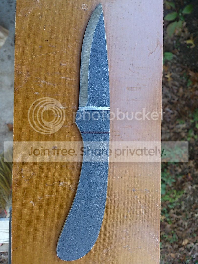

USA Knife Maker had some about 2 years ago and they called it Butterscotch. I have a piece and it is definitely more "butterscotch" than anything shown so far. It is linen and a little over a half inch thick. I tried to take a picture but I cannot get a good representation of the colors with the current lighting at my house. Here is an old picture with a partially ground blade sitting on a scratched up piece. It still looks darker on my computer than it really is.
