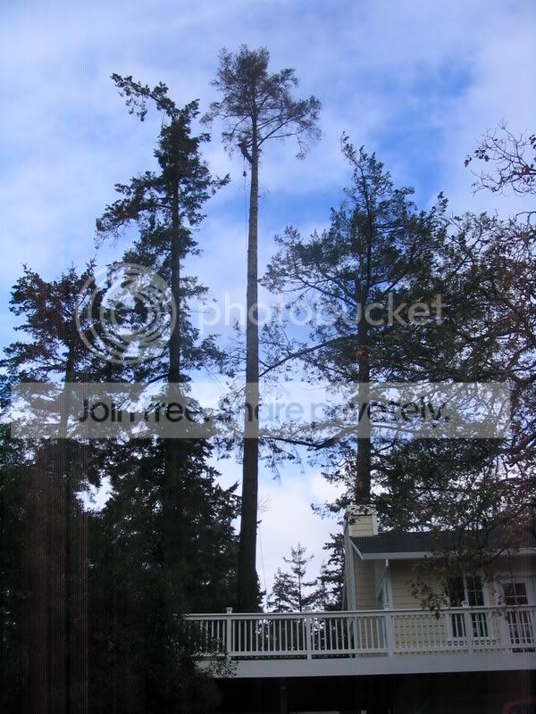

great view from up in those trees eh? nice to see a fellow treeclimber that collects blades too! :thumbup:

Whats up Bushman? Always good to hear from other tree people. My knives are actually work tools and therefore tax deductable. HAHa
I am always sportin' big wood.
[/IMG]
Matt
