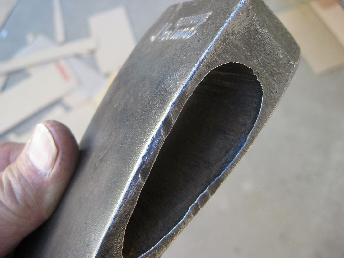

Speaking of hard steel. This thing was unreal. It just was not right. I just know some one had to mess with the heat treat. Brand new Finnish file was really struggling with this. So I pulled out a new old stock USA Nicholson. No better. A diamond steel yep but to slow. Ended up that the treadle grinder was the best bet. It has held up to a few swings in well seasoned maple but we shall see. It was probably a boys axe. I hung it on a 18" handle. A little over 2lbs, True American stamp.
That's very nice.
If it's that hard, I would seriously consider putting it in the oven at around 425-450 degrees (make sure you have a separate thermometer inside the oven and don't trust the dial or other settings!) for a couple of 1-2 hour cycles. That should bring it down to about 56-58 RC, depending on the steel and just how hard it presently is. You certainly don't want such a nice piece chipping, or worse cracking, during use.
Of course, that would mean taking it off the handle, but then you might also think about putting it on a 28" boy's handle:)
That's very nice.
Sounds like good advice. I have ovens at work that I can trust. I have plenty of boys axes but I don't have another hatchet over two pounds(except maybe a hewing hatchet). It actually feels pretty good.

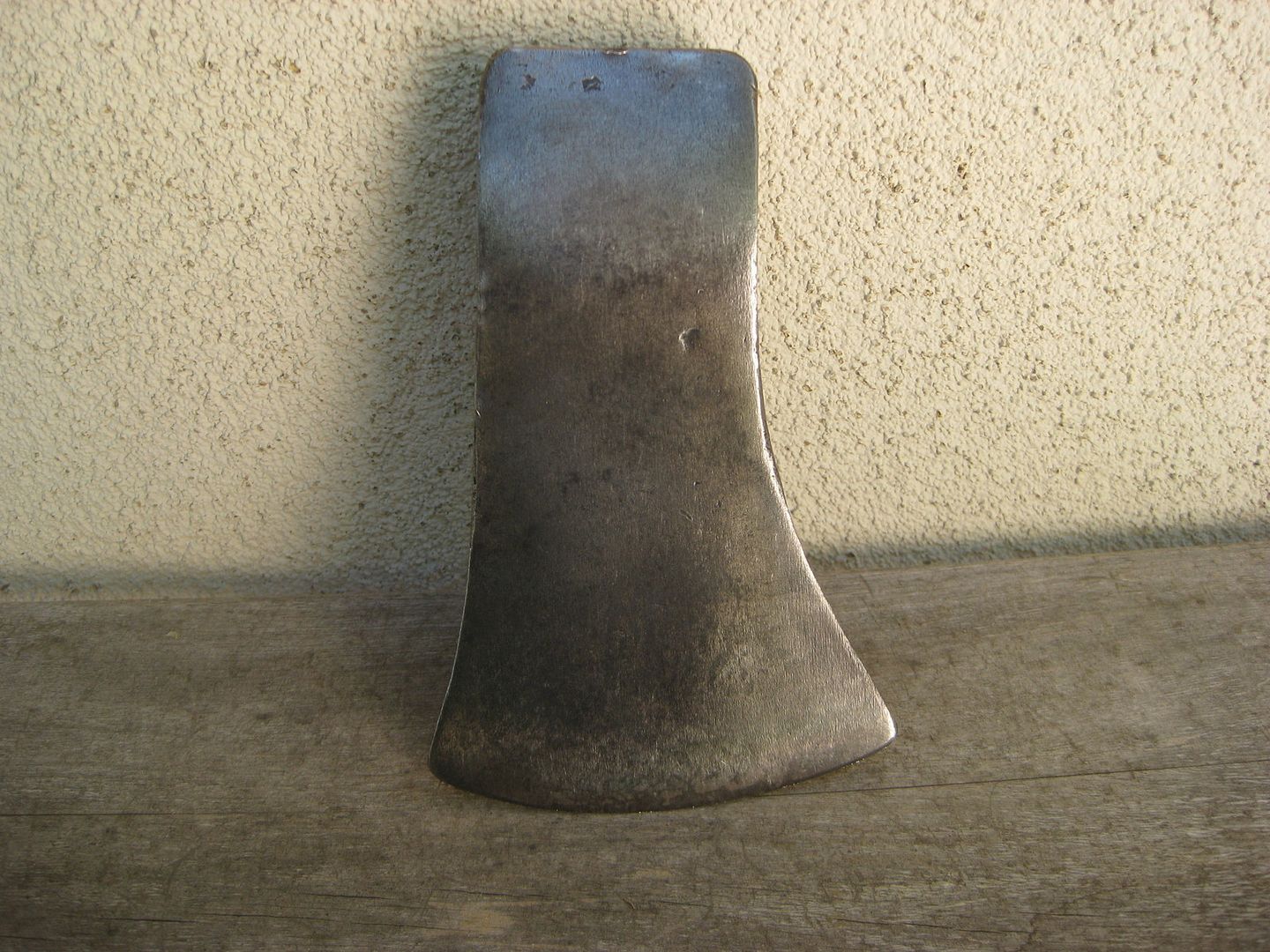

So I got this unmarked axe that was pretty rough forging/casting...almost 5#....not going to use ash nor hickory...ole school white oak and only a 30 inch handle...at 6'8" I really don't need that 36 inch handle.

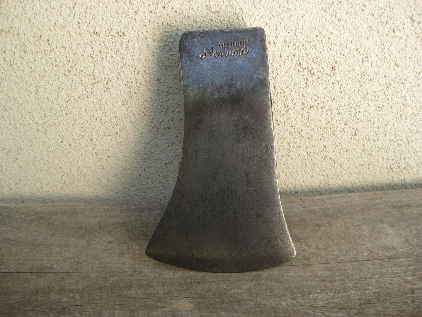

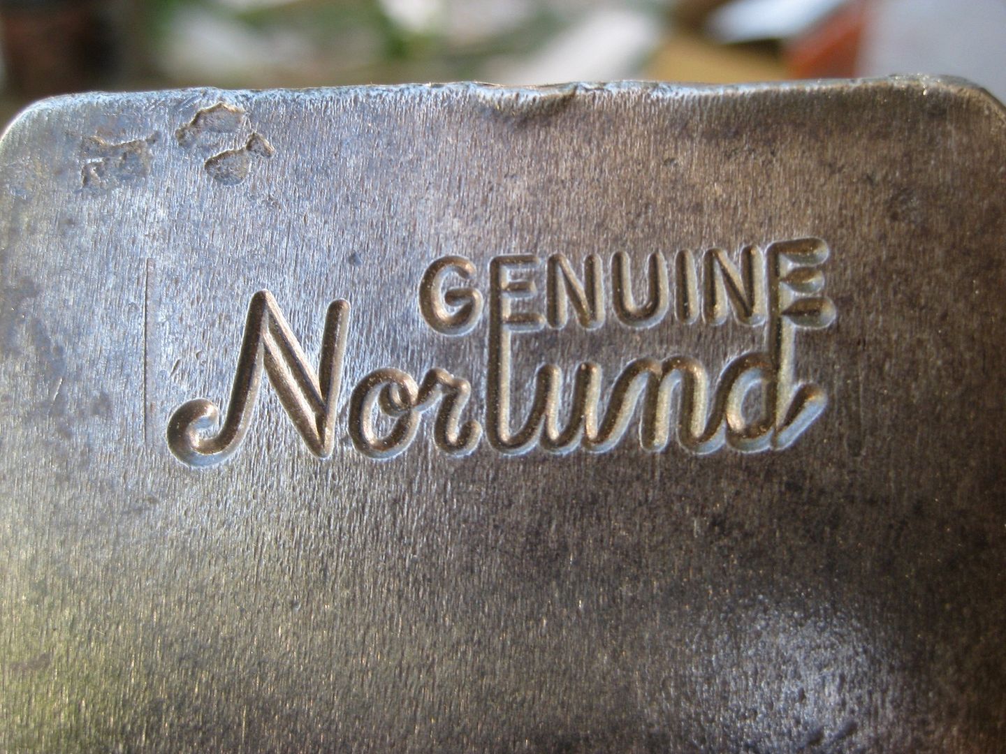

Next up for handling is this Norlund, but it will be heavily modified to look more Nordic....I will leave the stamp along guys, but it is just a quality head to me....I need it to be my working axe and a reflection of my style and background...
