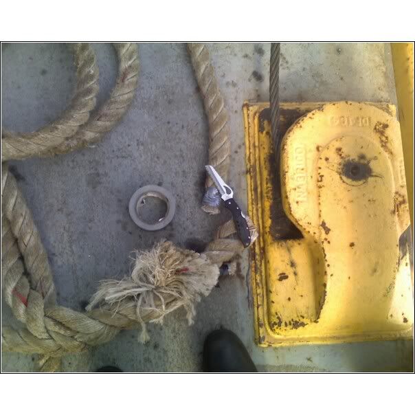

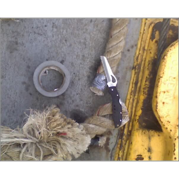

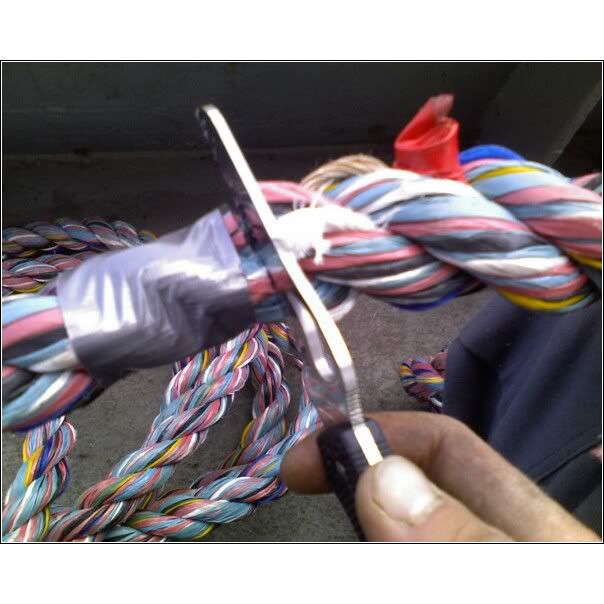

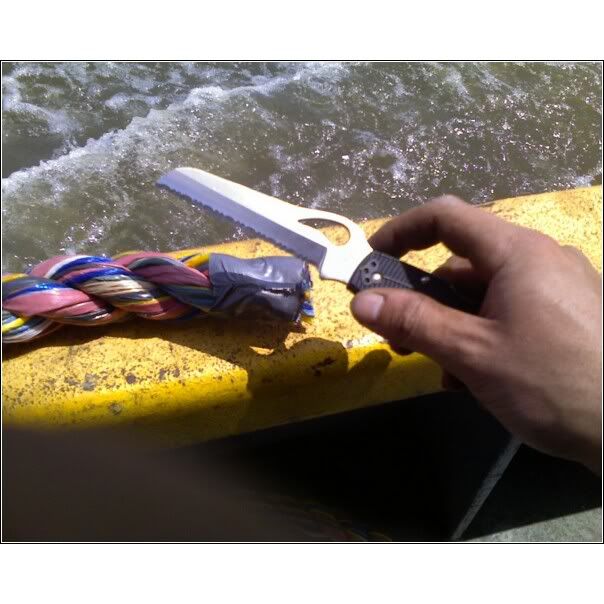

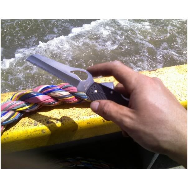

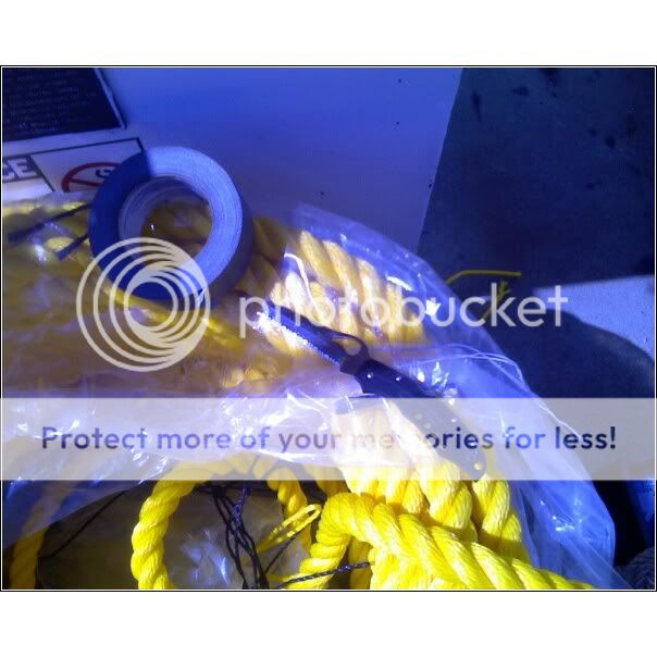

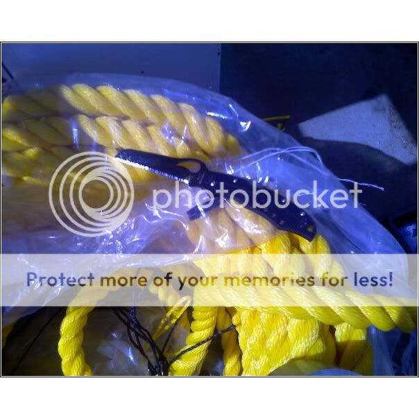

Here are some pix from the first trip I used the knife on. Enjoy.
Cutting Polypropylene leaving line from a coil for splicing:
Cutting 2 inch lock line to repair a stranded end with a new eye splice:
Cutting "Trash" or "Scrap" line to repair a splice:
