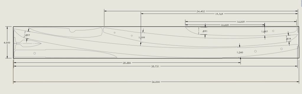

I'll start with the design

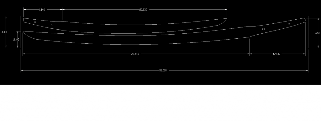

Here's a closeup of a yoroi doshi whose dimensions I cant show with the main block
Here is the full block, with dimensions of the three important pieces
So as you can see, I'm making a set of japanese style blades. I have shown the dimensions of the katana, waki, and tanto, including blade width at the habaki and the yokote. The stock will be 36x4x.270/.300 cpm 3v from Jantz, which i will have drop shipped to the waterjet facility.
Here are my questions:
1. The smallest dimension on the cad file is .05 inches. This includes distances between pieces, distance from the edge of the block, and the difference between the blade and the tang at the habaki. Is this too small? Are the tolerances of the blocks or the machines larger than .05? Does a jet cut a larger path that might create interference between patterns?
2. How do my designs look? Are the dimensions good? I wanted to keep them within a reasonable range for a historically accurate set. Obviously a lot of this part will come down to the grind, but just looking at the blanks, what are your thoughts?
3. Does anyone have any idea how much this would cost to get done? I have access to my friends cnc shop, but I don't know if he can get these tolerances, so I'm probably sending them off for waterjet.
My grinds will be fairly similar to Dan Keffeler's, but with slightly more niku right at the edge. I love his work, but I want to make these look a little more traditional (although obviously no hamon).
This is my first time sending things off for work, so I'm looking for c&c on the design. I'm not sure about tolerances for the shops or what instructions I would provide them. Also, what should the finished file be that I send? Is it sufficient to just have a dimensionsed dwg file, or do I need a cad file with machine paths etc.? Ideally I would like all tolerances to be less than .01, is that possible within some reasonable financial constraint?

Feel free to comment on or ignore the extra pieces, I just didnt want to waste material, so I threw a few designs in there that might benefit from a thick cpm 3v stock. If you have any ideas for the other wasted metal, I'm open to ideas
