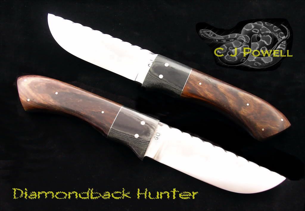

Hi Gang -
I wanted to introduce you to my 18 year old apprentice - Calvin Powell. He's been working with me since May '09, so just a few short months. He is an extremely quick learner and his grinding is pretty amazing considering his time at the craft. His fit and finish is right up there as well.
I'm trying to talk him into setting up his own "knifemaker" subscription to see if he can sell some of his pieces so he can start buying his own darn steel! ;):D
Take a look at his most recent piece - his "Diamondback Hunter".
OAL - 9 1/2"
Blade - 4 3/8" Flat Grind
Blade Material - 1095 High Carbon; Differentially heat treated with hamon
Bolsters - Linen Micarta
Spacer - Stainless steel .020
Handle - Cocobolo
Pins - 416 Stainless Steel
We would love to hear from the "knife aficionados" on the forums and get your comments. I'm a little biased since we work together daily. Whatcha think fellas? :confused:

wow that is very nice work.he is lucky to have a chance to be an apprentice in knife making.
That's some very nice work. I like the simplicity of the lines and it looks like (with that nice belly) it would actually make a great user as well. F/F on the handle is really nice, too.

Good work there, CJ. You have got a fantastic teacher / mentor. Very clean workmanship with a great combination of materials. I'll be keeping my eye on you, my young friend! I also like your snake motif. Very nice!!!
Wayne, looks like you've got one heck of an apprentice! I think what you are doing is extremely honorable. You are keeping the art alive, my friend!

Hi Wayne,
Of course I want to give Calvin BIG props for learning and succeeding so quickly. (I work and inspire youth every day, so I understand your pride.)
The construction is really tight, and he is already experimenting on embellishing. He will find a style all his own, soon enough.
I am going to offer improvements now. As mentors try to do.
Calvin: Filework is a fancy embellishment that usually is reserved for dressiest pieces, and the successful versions are carried out with a lot of precision. Unrefined filework adds little to a knife. If a little is good, a lot isn't always better. I would go easy here.
The backspine is dead straight. That's OK for now. In time, you will see how a curve on the upper knife will make the piece visually rewarding without disrupting usability. Probably even add to it. Do a search on MS Don Hanson III and study--and I am serious--STUDY his sense of flow in curves. So subtle, but the visual impact kicks you in the head like a mule.
