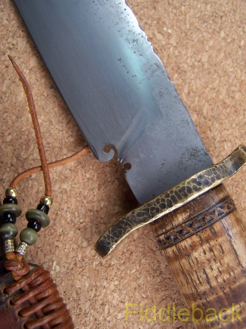

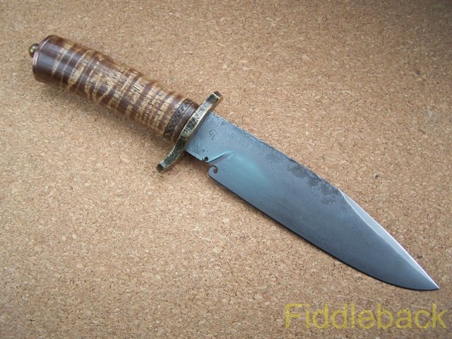

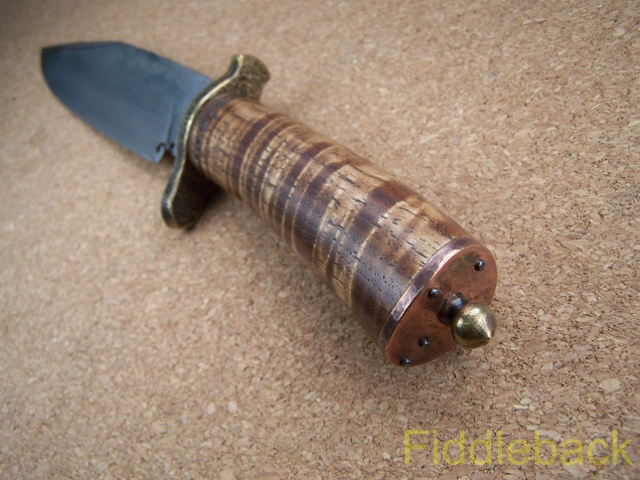

I came home from the January Guild meeting with this little Bowie, and wanted to show it to y'all. Its a beauty. Forged from an old Husgavarna blade, and still shows just a bit of the markings from the blade. I just loved all the details in this piece. The hammered brass guard, and formed copper buttcap. Then the wood is so damn fiery its a sin. Carl and I always discuss wood at the meetings, and I enjoy that a lot. He's into American hardwoods, and I happen to collect these as well. He has actually used some of my Red Oak on his pieces. He carves his wood a bit as well, which I think is a nice touch. Might have to learn that.

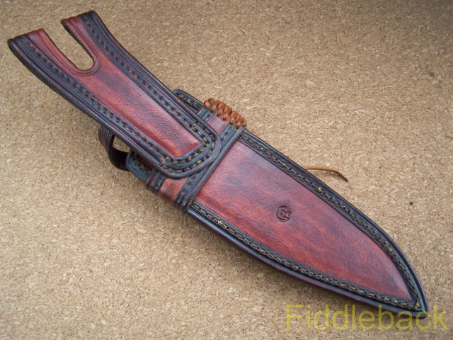

The sheath is a work of art also, and features grass carvings to match the blade. Its light too, and I'm going to have to appropriate this frogged bladeslip design. Its just so light. I'm in awe of the sheath every time I look at this knife.

Blade is forged from a commercial grade Husky mower blade which I have done some very extensive testing to insure it blade worthy. Husky will not give out spec sheet (as of yet), but forges, HT's and performs best when treated as the Cru V steel (1084 on steroids). The handle is curly hickory, one of my favorites. Not to show Andy up but the buttcap is also hammered brass, however it is naval brass (more copper) and responded slightly different to the patina process than the guard.
This was one of those knives that just got better the further along construction went.
