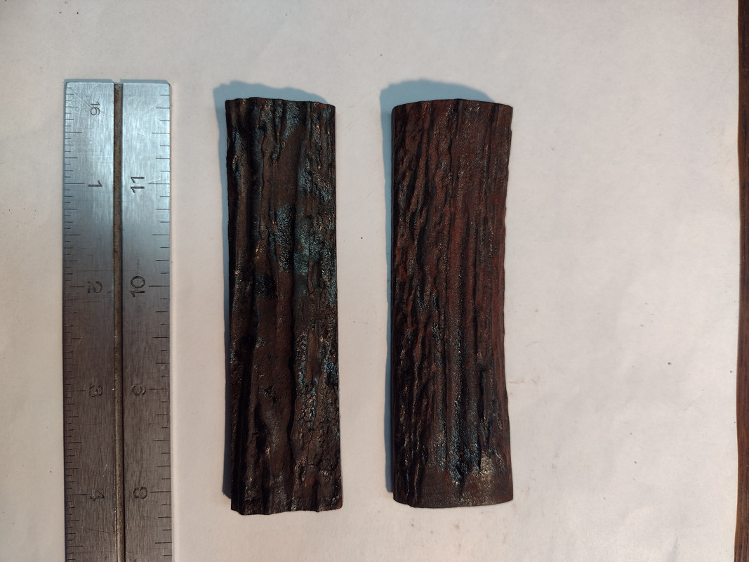

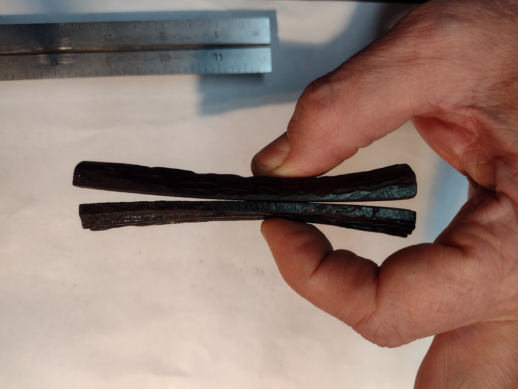

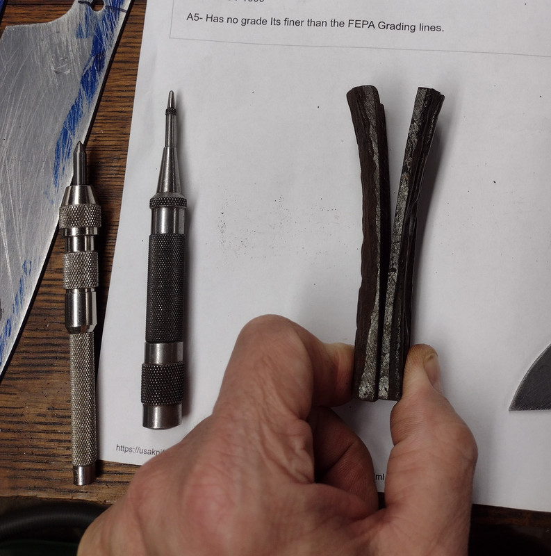

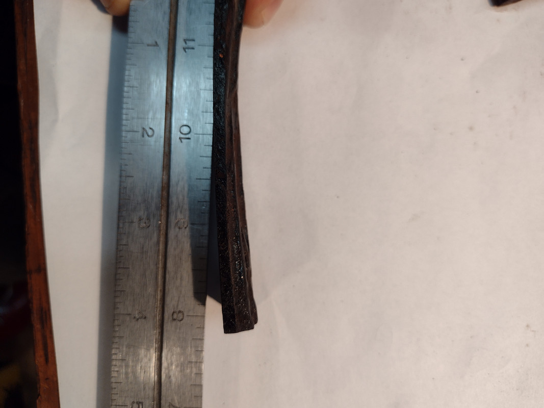

I've been wanting to use more variety of scale materials.
I bought some stag scales for about $36
I'm not sure if this is normal, but the are Very Curved. I'm not sure what to do with them?
If this is normal, what do most people do....Boil them? Soak them in chemicals to soften them, and clamp them to something?
I would like to keep them long, they are around 4+ inches long.
Worst case, I cut them in half (and use them as bolsters, butts, or accents?
Fortunately I use fasteners as hardware, Not pins. So with my screws and adhesive glued to a micarta liner might help. I just need to take out this initial Curve.
Thanks for all suggestions.

Ok, I've got nothing to lose....
I'll try the soaking method.
Here is the Before pictures.
I'll update this post in about an week.
I'm not in a hurry for the scales, I don't have a knife slated for them yet
