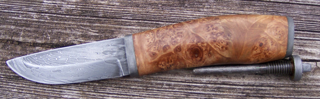

This is my first Gallery posting... Comments are most welcome.
Stats
Blade and Fittings Forged from 1" diameter 16x9 IWRC Extra Improved Plow Steel Cable
Blade Length: 3.5";
Blade Width @ Ricasso: 1";
Blade Thickness; Roughly 1/8";
Total Length: 7.5" (excluding ferro rod assemby) - 8.25" fully assembled;
Ferro rod Assembly: 3"
Handle Material: WSSI Stabilized Maple Burl

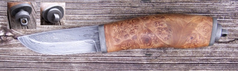

This is a gift for my Brother-in-law's birthday. He is an avid hiker/camper, so I thought this Erik Boese inspired knife with integrated firestarter might come in handy.

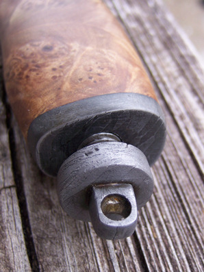

The rod is hidden in the butt.:eek:
Just screw it in and out:
The rod assembly was pinned, then hard soldered together:
Comments Welcome-
Thanks,
Mark
