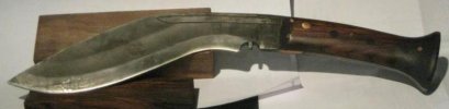

I rehandled my 12" CAK by Murali Kami
First picture is before and the 2nd pic is the after.
3rd Pic (here) is getting the wood handles off. I partially drilled the pin out but realistically they will punch out if you go in the right direction using enough punch & hammer. The scales came off fairly easily. Don't get me wrong laha is tough stuff and will last for generations. It just doesn't hold up well once you get the pins out and get a sharp chisel in there.
At this point you could stop and leave the bolster & pommel in place and just replace the scales with another wood or synthetic. I had delusions of solid copper; bolsters, pins and pommel. It didn't happen because the skills to do that are beyond my patience at the moment:grumpy:
4th pic is removing the Pommel. A bit of heat with a torch and its not much trouble. The bolster came off much the same way a little heat and big pliers.
5th pic is where I sweated a piece of copper onto the blade so I didn't have a gap underneath. The Kami's actually cut a notch in the blade where they start the bolster and then wrap a sheet of white metal or brass around the blade to form the bolster. I think they do this and then shape a horn or wood handle to fit under the bolster and secure it there with laha.
I have a lot more respect for the Kami's now that I have dismantled one of these and seen the work involved in making it.

After getting the handle fully removed. I called in a favor from an auto mechanic friend of mine and sand blasted the blade (1st pic this post)
Next was getting it de-greased and a bath for a few hours in White Vinegar (2nd pic this post) This is purely aesthetic and is called a forced patina. You can also use gun bluing. I went a step further and did a ferric chloride etch after the vinegar.
3rd pic this post is after the FeCl etch)I then wiped the blade down with mineral oil.
4th Pic this post is the roughing out of the "new" handle with a wood rasp. The holes that the Kami's make in the chiruwa handles for the pins are actually much larger than the pins. My guess is they use laha on large handle scales set the pins then shape the handle scales down. I couldn't find pin stock large enough for the holes that were there so I added 5 more for aesthetics and to make sure I could line up my handle scales consistently. I actually used walnut dowel to replace the original pins then used copper (electric wire actually) as my set pins. There is no adhesive or epoxy at this point because I finish the scales entirely then apply them with epoxy later.
5th pic is thinning the handle down. The wood is a 3/4" thick board of cocobolo

with the temporary pins in place I finished shaping the handle. You can do this by hand with smaller rasps and sand paper. I prefer to use a drum sander attachment chucked up in my drill press and a 1" belt sander. I you have a respirator or dust mask available use it! I was hacking up wood dust & spit for about 2 days after I was done. With the temporary pins in I went out to my wood pile a few times to test the handle shape and made a few adjustments. When I was happy with it I started at 120grit sand paper and worked my way up to 1500 grit. That is what you see in the first picture here.
We all have our DOH (Home Simpson moments) the 2nd pic here is mine. You are supposed to wipe up excess 2 part epoxy off with paint thinner or mineral spirits. I had my epoxy mixed applied and pinned before I realized I was out of mineral spirits to clean it up.:barf: That one mistake cost me 3 hours to finish that handle and remove the epoxy by sanding out that nice 1500 grit finish:grumpy: If your not making mistakes you aren't trying hard enough.
The last pic brings us back to the finished blade.
Things I learned here that might help others trying it. 1) be patient don't rush it you'll regret it. 2, dull or tape the blade up, at one point I had vacuum line tube duct taped over the edge, I didn't learn this one the hard way I was smart enough to do it so as not to get cut.3, if there is one tool I would not give up to do this job it would be the vice (6" Wilton) it goes beyond an extra set of hands and actually becomes a tool onto itself. If anyone wants the details I'll discuss them. Please take any of my other power tools away but don't take the vice. I have bent, formed into a u shape 7/16" aluminum bar 2"wide around a 2.5" diameter mandrel using that vice and my own weight, it ain't going anywhere:D
Thanks for looking
Ray

OldSchool45, did you notice any difference in balance after leaving out the bolster and pommel?
Jay, Its actually been my favorite "dog walking" knife for a few weeks and it goes on my hip while doing lawn work.
Warty, the sad thing is that the respirator mask I use for indoor shooting ranges was sitting on my bench in plain sight the whole time:barf:
Dan, leaving the bolsters and pommel off might have shifted the weight a hair forward but not drastically. If I had used solid copper for the bolsters it would have made it handle heavy. There just isn't a whole lot of metal between the bolsters and pommel to throw the weight off and it would be less pronounced in a bigger blade. I really like a metal pommel to protect the butt of the handle if you drop it. Please don't ask me how I know.
