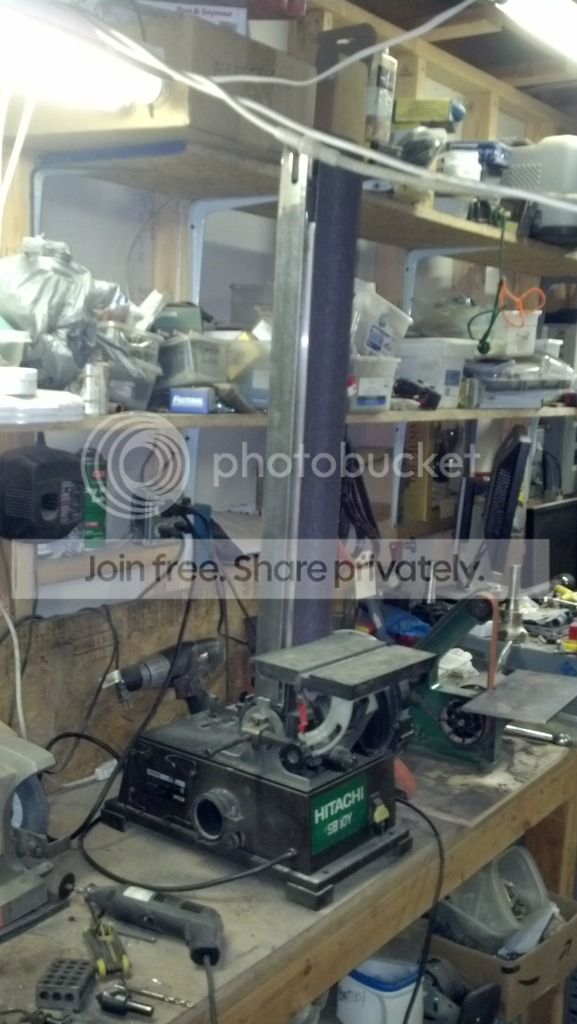

I don't have a fancy belt grinder. I do have a 4x36 benchtop sander.
A thought occurred to me to modify it so I can flatten out forged material and turn it into "flat stock" for later use on my CNC.

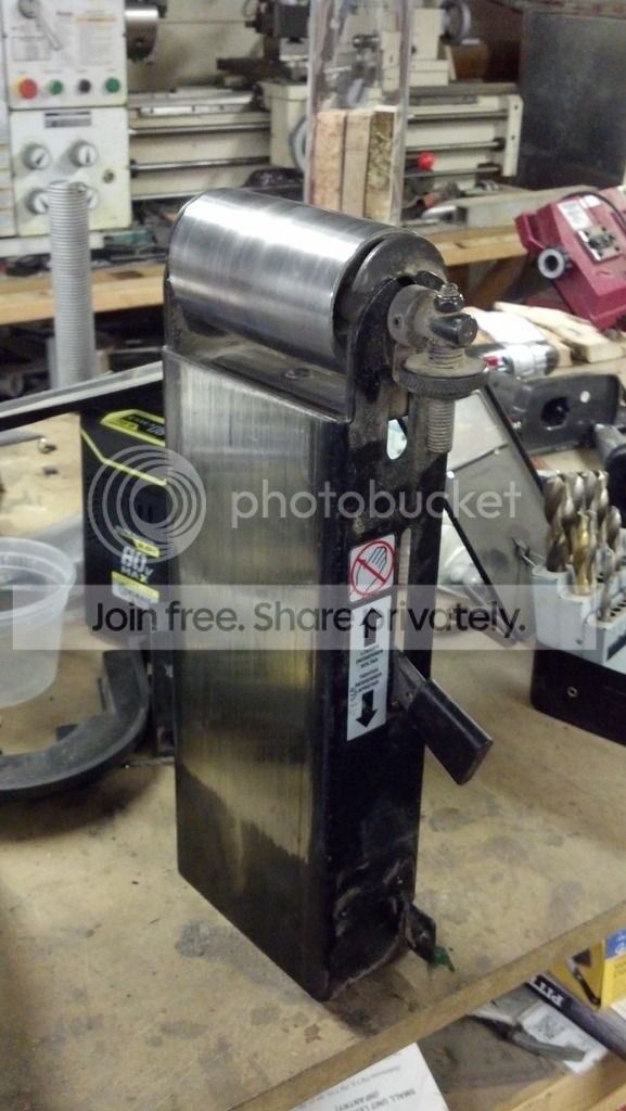

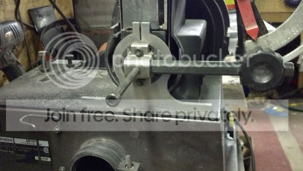

I found out I can separate the sander into the motor section, and the "platen" section we can call it:

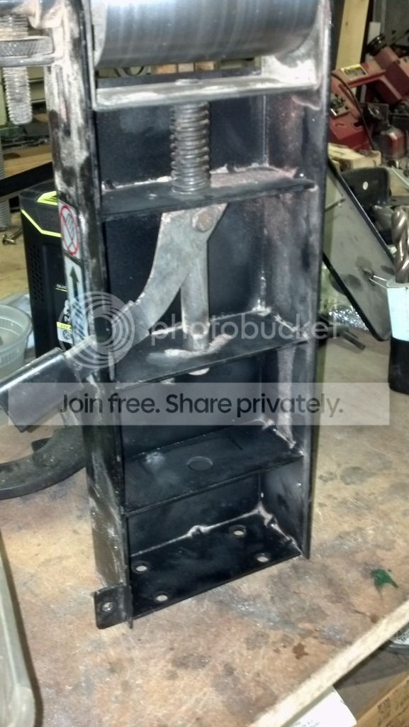

By reproducing the platen:
All I have to do is use a 3/8, or 1/2" thick precision ground top plate, and some angle iron, and I can reuse the rollers, and mate the whole structure to these 4 holes on the machine:
I should now be able to sand close to 24" long billets flat enough to put them on my CNC. I know that it will put more stress on the motor, but if I dont press as hard on the billets, it should be about the same load that I put on it normally. Also the motor has thermal safeguards against some stupidity.
What do you guys thing? Brilliant, or Bonehead. The "upgrade" will be less then $100.00

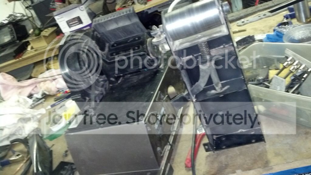

Just finished it. will do a further test tomorrow:

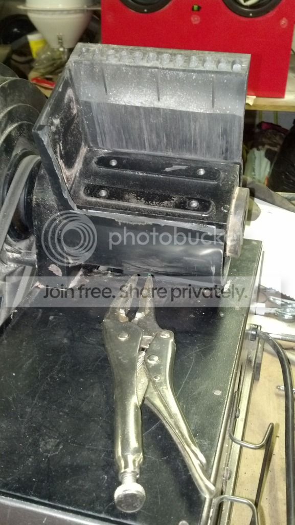

So for less than $100, I converted it into something of a faux surface grinder. There is a 4x24 x 0.375" ($62) slab of precision ground low carbon steel under the belt as the platen surface.

Added this small bracket, which kept the additional weight distributed.
One of the benefits of having a CNC. Making small things like this on the fly. It simply is just pressed on with hand pressure, and just sits there. Doesnt need to be bolted down.
And here is where it rests:
I can take just about anything and push it against the belt. Runs smoothly and still eats away material with very little bogging down.
For under $100 it has been a VERY wonderful upgrade to be able to grind flat long items.
