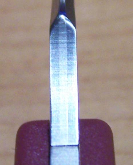

In the picture below of the ZDP Caly there is a horizontal line running along the blade, does this have anything to do with the lamination?
Also, wouldn't it be possible to eventually sharpen and wear away the ZDP laminate leaving the 420J2 exposed?

I don't think so. The layers are like a ham sandwich, the bread is 420, the ham is ZDP.
Code:
       420:420:420:420:420
spine  ZDP:ZDP:ZDP:ZDP:ZDP:ZDP:ZDP:ZDP   edge
       420:420:420:420:420
The ZDP is exposed when the blade is ground. The ZDP will last as long as the blade does. And unless you're aggressively re-sharpening w/ diamonds every day of the week, the blade should outlast you (barring any huge jump in medical technology :) ).

Pic below is of the thumb ramp of a ZDP Calypso Jr. You can clearly see the center core of ZDP between the outer layers of 420J2...
...you can see the same thing if you look down on the spine of the Caly 3.
