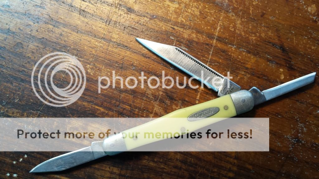

Here's a Camillus in yellow:
Those are great little knives Mort. Here is my 72Y Yellow Jacket Whittler. I like the way Camillus described the small clip blade as a "Pen Clip".
Camillus' Description:
CM-72Y Yello-Jaket 3 Blade Whittler
420HC stainless steel blades
Yello-Jaket etch on main blade
Smooth yellow Delrin handles
Nickel silver bolsters and nickel silver oval Camillus shield
Brass pins and liners
3 Blade Whittler clip, pen clip and coping blade, 3 5/8" closed
