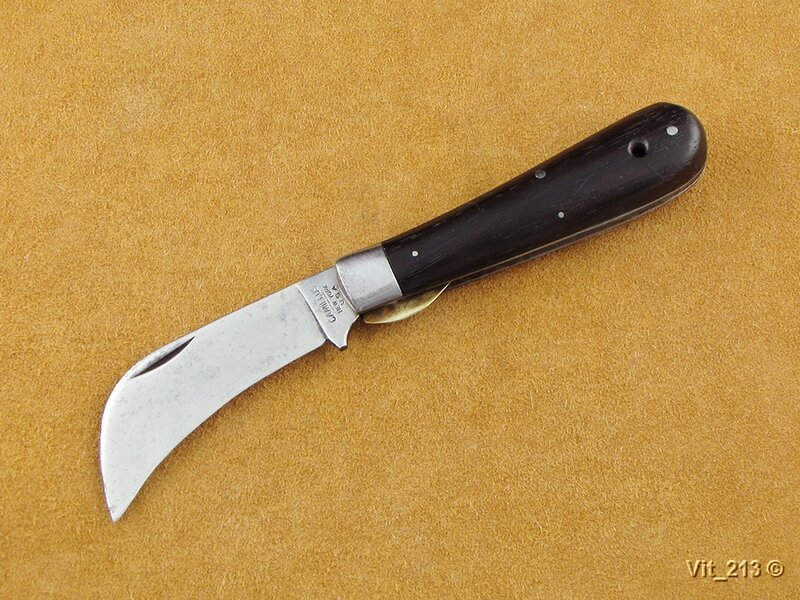

I rehandled a camillus hawkbill 1 and sold it to my brother to give as a gift to someone at work who is retireing. He wanted more info as far as when the knife may have been made. The knife is stamped "Camillus new york USA" on the opposite side it is stamped with a "1". Any info as far as dates the knife may have been produced would be greatly appreciated.
Big spread possible with only that info.
Can you post a pic; I may be able to narrow in down a bit.
this is of the finished knife, i dont think i have any before pictures though.
Hope it helps
Looks Good!
Best guess 1970 - 1990s.
Thanks for posting the pic. :thumbup:
Thanks for the help, what of the knife made you come up with those dates? Just curious.
Your description of the 3 line Camillus tang stamp implies 70s or later.
I believe the last run of the blades in the 00s we omitted the #1 stamp.
My memory is not what it used to be, but I am pretty confident I am in the ballpark.
Was the original handle a wood grained brown delrin, swelled to the butt, with a large nickel silver clevis?
Photo tang stamp would reduce this timeframe :)

Don't remember if it was delrin or wood, but it did have that clevis.
Vit-213,
The model 1 hawkbill pruner (Camillus #07 pattern) was first made in 1946. It was made before that date, but it would have had a different model number (probably a 4 digit sales number). Camillus began using a new numbering system after WWII.

That is a beautiful way of presenting a knife. It also is a fine looking example. The one I have in my collection is not nearly at pretty as yours, but, she still keeps a remarkably sharp edge for an 'old gal'.
