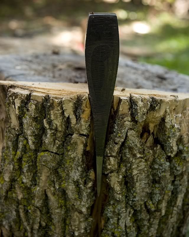

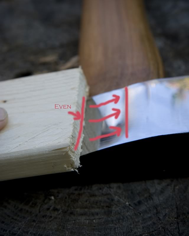

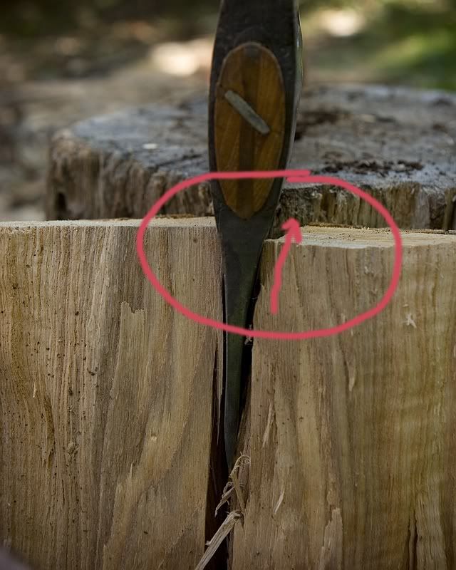

Like Kenk said, the Hudson Bay style head is not known as the best splitter. However, I do think it makes one of the best "all rounders" for doing many things.
I have done several side by sides with the GB SFA and 18" Penobscot, and the Pen bay far out splits. Of course, the head geometry here near the eye is key, and a real sticking point on the GB's:
Good:
Not Good:
Yeah ... that Hundson Bay style head is also, well, just beautiful. I don't know what it is, but I like how the Penobscot feels in my hand. That's part of why I tend to bring it along even when I bring the larger 3.5# axe.
