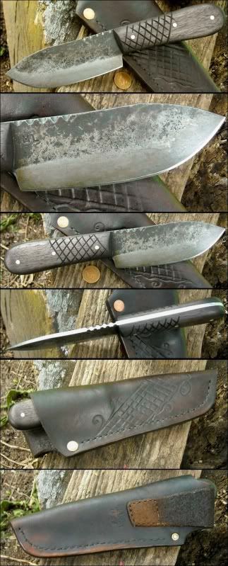

Overall John's knife did really well. Brian is clearly happy with John's work. After all, Offthemap outfitters was a retail outlet for many of John models for a while until Brian start selling his own blades. In fact, because Brian has handled so many different knives via his company, was also making them, and is an avid outdoors person, I think he has a unique set of experiences to complete the review as well as he did. He has an incredible eye for picking out details, but at the same time doesn't get so bogged down in fit & finish parts that he looses the goal of evaluating performance. Brian is also one of those guys who really does use a knife the way he projected. Having watched him when we were camping together, he actually does switch his knife holds frequently.
Anyhow, my thoughts are that every knife in that line up had to deal with compromises and it was made even more difficult given that the set of tasks at hand weren't explicitly stated beforehand. I think all the knives performed well given those constraints. Johns did well at many of the tasks. I'll agree with his assessment that a more rounded handle would have increased his points on some of the tasks. However, as Udtjim points out, this is largely a reflection of the way the tester uses a blade.

My comments about handle shape are my picky preferences. It may not be others, and I know there are people that have used those finger features without issue. However, I do like the knife handle you posted earlier in this thread, and I REALLY think that would be a cool combo (that handle, competition blade shape). I would not hesitate to take that knife anywhere.
I also like the thickness you selected in your knife. Not too thick, not too thin.
I know I did point out a few things in the "fit and finish" area on yours John. However, you have to remember, I was just "pointing out what I saw." Another thing that was probably not emphasized enough was price point. Performance to price ratio on your knife is extremely high! Had you worked out all the nit picky details that I did point to, you could very well be charging 3x the amount for your knife due to extra time. I personally am not sure you want to do that.
Finally, one of the things I really liked about your knife is the final grind geometry. If it were my own personal knife, I would probably feather it a touch with a 400 grit belt, then 600, then hit with a couple leather belts and compound. That is just the way I like them. BUT, the appropriate thickness is there and great! I have seen a lot of convex knives left way too thick in that area dropping the performance exponentially. Yours is nice!

There is always going to be a compromise of sorts with any knife and I think you made the best choice with your camp knife John. Had you gone to 3/16" stock it would have chopped better but the performance on the other tasks would likely have suffered !
You could have widened the blade a little toward the front to throw more weight up front but I'm not sure that would have made too much difference.
