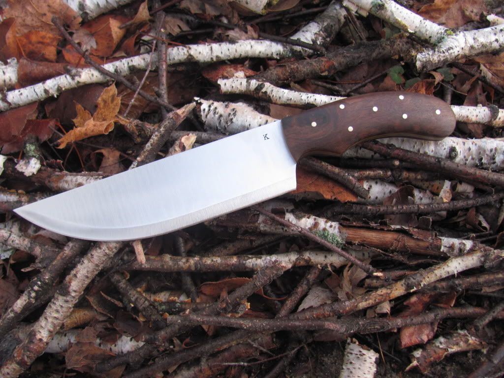

This one was 1/8" x 2".
oh wow. that looks great John. what's the length? and what did you use for grind on that one (if you don't mind me asking)?
I would go with 3/16 stock and a full flat grind. that will cover your slicing and be heavy enough to use it as a camp knife. Just make sure you use a steel that can take the abuse so if you do use it to chop or split/baton it can take it. The maker can tell you what they feel is the best.
I believe it was 6 or 7 inches long, I`ll check the pattern tomorrow. It had a scandivex grind.
