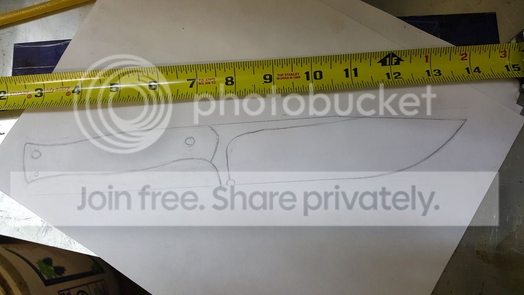

This is my initial sketch. If you guys have any critiques you'd like to share.
Blade looks perfect!, handle needs work. Keep top of handle straight or slight curve. No concavity like you have on the back end.
The sharp edges on your notch will catch on a lot of things. Smooth it out on the blade and guard. Maybe a pin in the middle of the handle. Make a mock up of the handle to make sure it is comfortable in your hand.

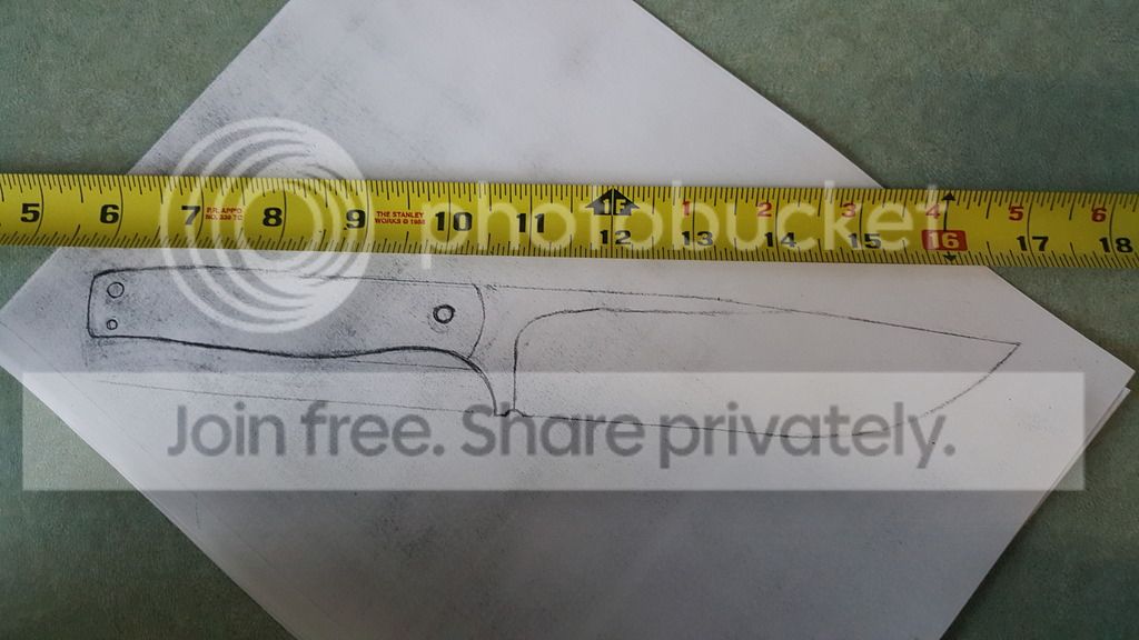

The notch what a bit over exaggerated. Should be more of a sharpening choil. I did a handle mock up and was not pleased. I think I'll end up doing something closer to this.

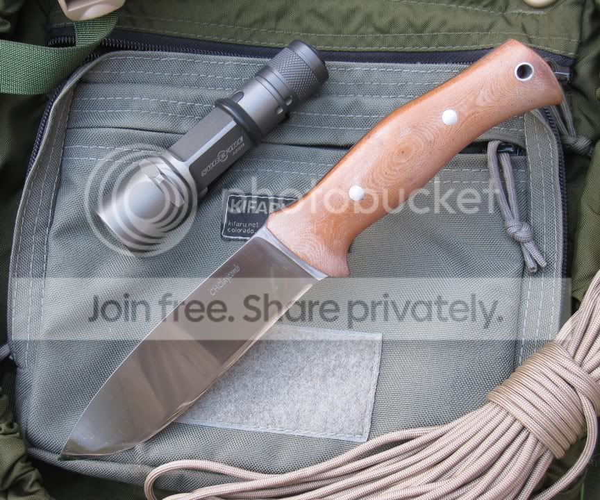

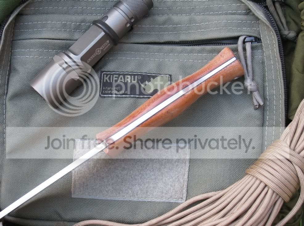

On the handle, I think you have made it too skinny / not deep enough, and particularly not enough to balance the depth of blade. Could be wrong and it might just be the photo, but it looks like the handle up at the front end is less than 1" deep while the blade is pushing 2". That front part of the handle is what you are going to be hanging on to to resist blade torsion whether you are chopping or just carving feather sticks. Its going to be hard to make it comfortable for medium to large hands with less than 1" depth. You don't really need finger clearance space between blade edge and handle like you do on a kitchen knife, just tip the blade forward and cut a little more on the belly when working on a board.
At the butt end, if it was me, I would have kept that convex area since they can work well to improve grip and resist the knife trying to leave your hand when chopping or snap cutting. A knife like you have drawn is great for de-limbing saplings with a snap cut.
I hope you don't mind me posting photos to illustrate what I mean...I will take them off if you want.
If you want to chop, you can drop your hand back and that necked area can be great for giving a secure grip.
