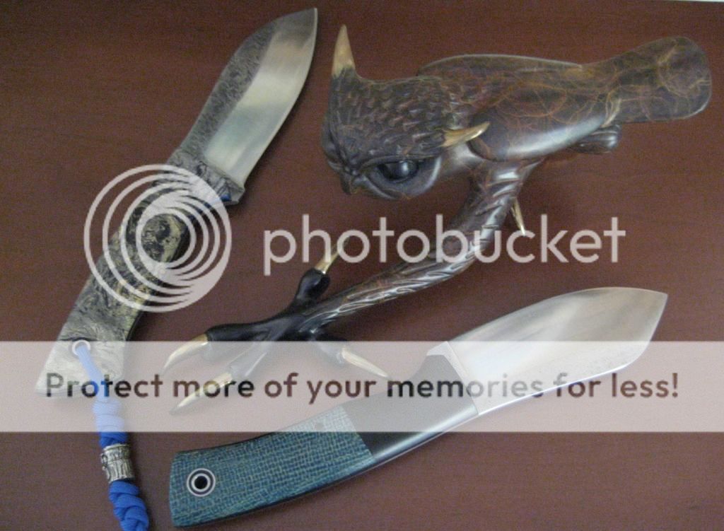

Believe it or not even our knives enjoy taking a little vacation to explore new & exciting places. Thanks to the generosity of one of my fellow forum buddies Comprehensivist, I was provided an opportunity to get a first hand feel for a Fiddleback Camp Nessie, and a chance to compare it to my own WAS Kodiak.
Following the same format that Comprehensivist outlined in his post of 11.20.14 #64 in the Models, Tang Types, Steel Thickness, Weights thread here are the technical specs for both knives:
Camp Nessie:
FF Lot Info: 2013 0823 012

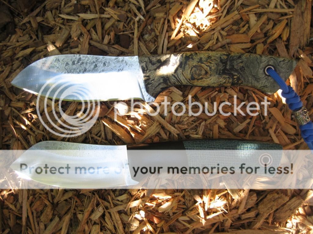

While both these knives are beautifully balanced and share similar DNA being variations on a Nessmuk theme, there are some subtle differences:
Aside form the materials used to craft these knives & the grind, perhaps the most significant difference is in the way the handles are shaped. I believe the handle of the Kodiak is very similar if not identical to the ever popular WAS Bison, while the handle of the Camp Nessie is unique from any other Fiddleback, and offers a comfortable choke-down grip when used for chopping or shelter building. The Camp Nessie is also guard-less which allows for additional versatility when prepping food at the camp site.

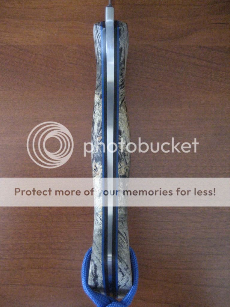

Handle contours of the Kodiak:

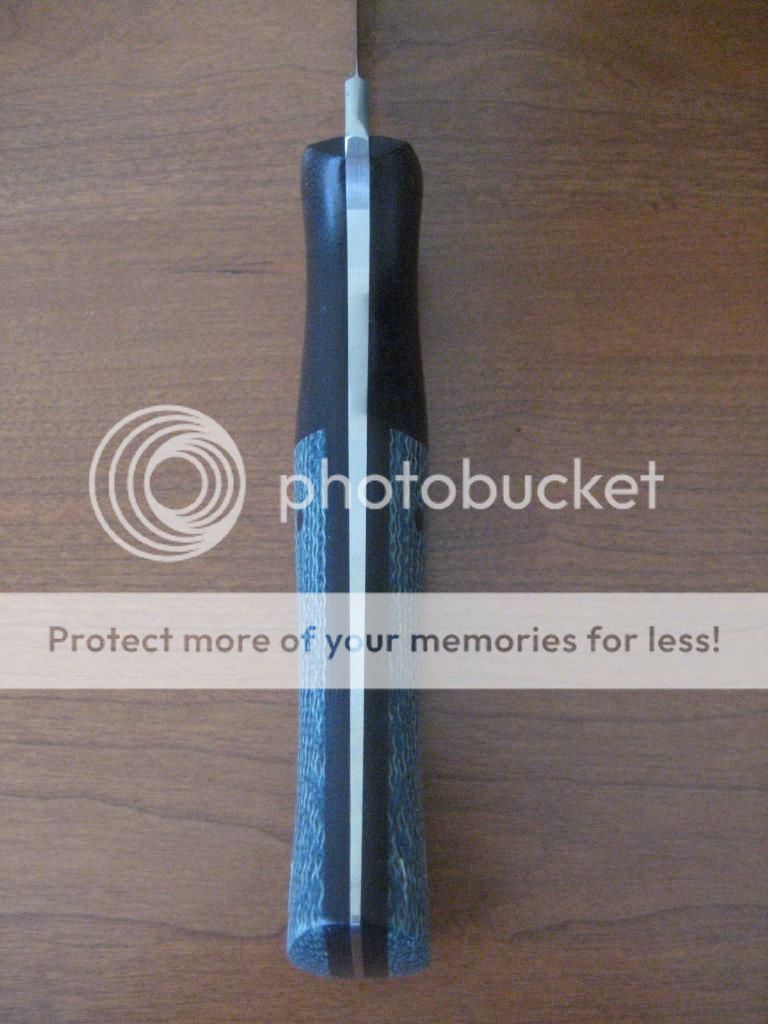

Handle contours of the Camp Nessie:

The handle on the Kodiak is somewhat flatter & wider than the Camp Nessie. When held in a pinch point hold, the Kodiak feels more positive due to the deeper contours around 3/4" from the leading edge of the handle. The "quillon style" flaring of the Kodiak handle provides additional security in a reverse grip or fist clenched forward grip. As mentioned above, the handle extension of the Camp Nessie allows for the hand to choke down more comfortably to gain leverage when chopping. It also tends to fill the hand due to its greater circumference at the palm swell.
I was fortunate in being able to shark one of Allen's Kodiak's particularly since some of our camping is done in coastal areas where the higher humidity & proximity to salt water favors the use of CPM-154 steel, not to mention being beautifully tapered. That being said, I plan to keep Andy's Camp Nessie on the top of my acquisition list given it's classic styling and comfortable handle ergos.
For now, my Guard Owl is keeping a close watch on both till it comes time to box up the Camp Nessie and send it back to its home out west.
A special thanks to the both Andy & Allen for making these fine tools, and to my good friend Phil for his generosity in allowing for this transcontinental comparison.

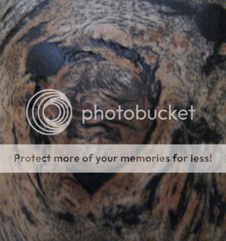

Peter, your Kodiak is freaking me out. I swear there's an old man face staring at me from that knot in the middle of the handle. Or maybe it's an Ewok. :confused:

I was hoping that you would post a comparison review of these two knives. You really nailed it describing the similarities and differences between them. I appreciate the side by side pictures that show the relative scale of these two models to each other. I think a lot of people have been waiting to see a picture of these two models together. That visual reference is more meaningful to me than a stand alone knife photo with the measurement specs posted.
Your Kodiak is a primo example of that model. I like the fact that it is stainless with very nice hammer texturing on the flats. I'll defer to the Mystic Seer Kris :D to enlighten us on what face is staring at us out of that beautiful wood. All I know is that is a great looking knife. I agree with your observations that it would be a little more versatile if it was guardless and maybe had a little less angled flare at the pommel end. But hey, that is really part of Allen's signature style that makes it easily identifiable as a WAS knife.

Ok, lets see if I can freak Kris out a little more......based on this photographic evidence it would appear that Allen has indeed released the spirit of some type of mystical being within the handle of this knife.
