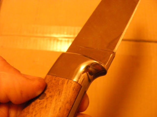

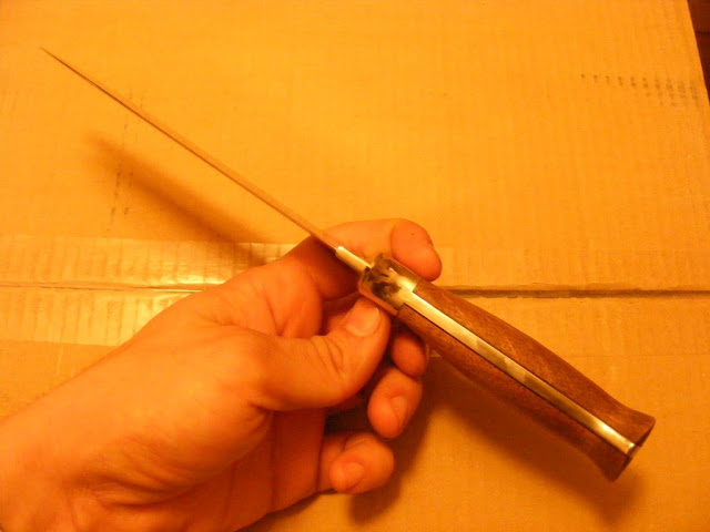

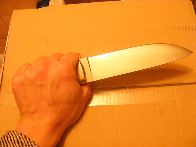

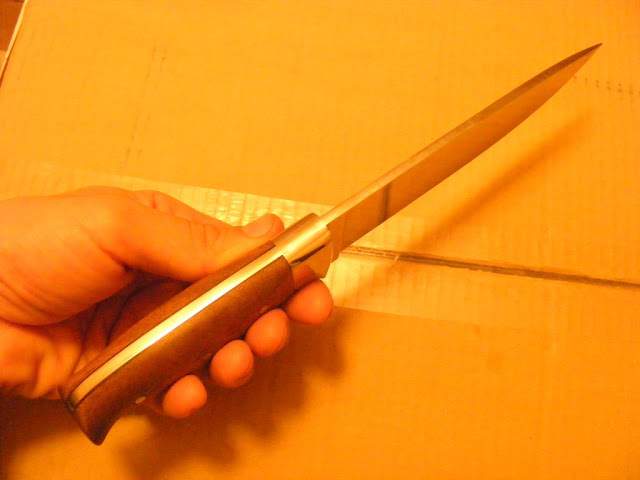

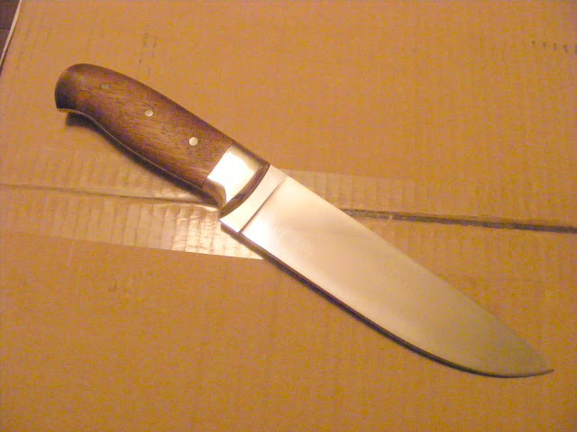

I finished this yesterday. Steel 440B, 304L bolsters, wallnut slabs with leather spacers and stainless pins. Blade shape is like on a Cold Steel Long Hunter. Customer request. :)

440B isn't a steel I see used much in custom knives. I'm curious how you came to choose it?

It is not that I choose it. The steel choose me. :D It is only steel that I can purchase in sheets from Austria. When I ask for 440C - they say - if you purchase 2 tons - no problems :foot: I have RWL34, but it is brittle for such big knife. I have Latrobe14-4CrMo from UsaKnifemaker.com, but it is only 38mm wide stock. Only good stuff i had for long and wide camper like this was 440B on a sheet. It is not a bad steel. 0.80-0.95C is good amount of carbon. 56-58 rockwells are most common hardness for it. I dont need harder blade for that knife, don't I. :)
There is no secret for that steel. HT - 1050C, quench in oil (I cover it with clay to avoid decarb and scale). Temper - 2x2hrs on 220C.

440B has better hardenability than 440A, and smaller carbides than 440C. In theory, with an optimal HT, 440B would probably show better fine edge stability than the other two.
I don't know, Mete. Users of RWL34 knives says, that the edge chips when they work choping and carving wood. Hunters just love it, but for short knives and hunters. And I have short and thinner piece from it. Preety expencive stuff. 440B is also cheep, thick (4.8mm), and I don't have to worry about the widht. I say again, friends - I don't have wider stock other than 440B. :)
It is 17cm blade. allmost 7"
