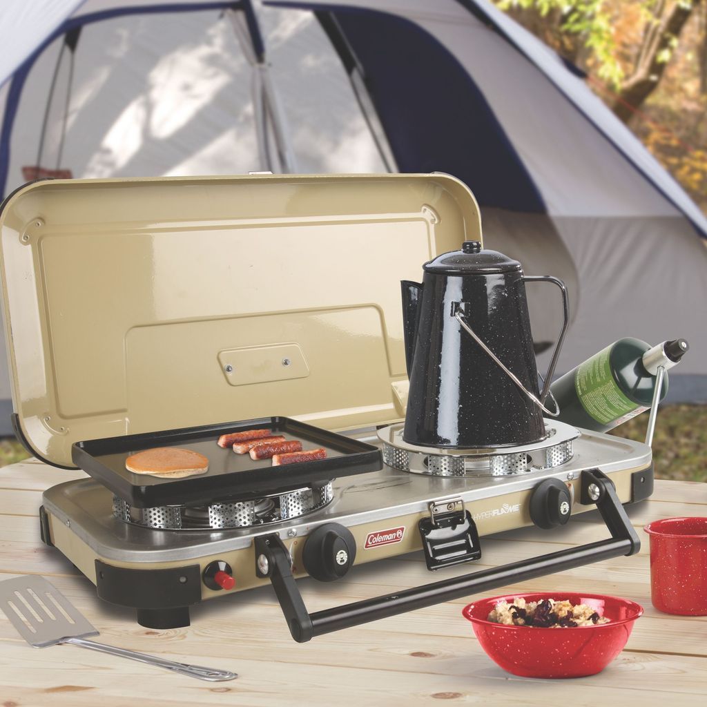

Just an update for anyone interested in a stove...I ended up purchasing the Coleman National Parks Edition Fyreknight. Only fired it up to test it...it seems awesome! I'm very excited to actually try it out and put it to work. Flame control seems to be pretty great. I didn't necessarily care for the logos, but I didn't mind them either. My wife and kids liked them, so that's their part in all this. I've ordered the parts I need for my old Coleman 426B; so, I'll make sure that one is up and running as well.
