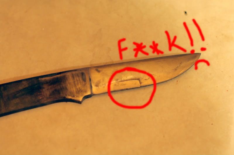

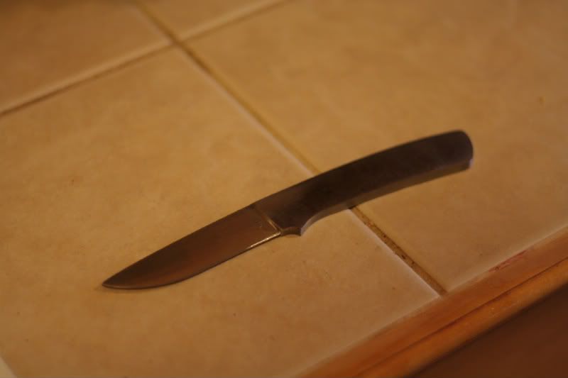

Completely off topic but do you guys know a way to express a hamon without using ferric chloride. I happened to throw a bit of furnace cement on this knife to see what I could get.
Quenched in water, you'll probably start to show a quench line just from polishing the knife higher. 1080 won't get a really active hamon like lower maganese steels will, but you will probably get a transition.
As to the second temper, Robert (mete) has said before that there is no need for a second temper in 10xx steels. I don't distrust him, but I know that it's not hurting mine to run a second temper and it might just get it over some nose of time at temp that I missed on the first go round. I also temper lower on the first cycle due to variance in ovens, if everything were perfect maybe I'd do things differently.
There are a lot of variables to consider on this one - the clay, the actual temp and time at temp, for example. I'm sorry that you lost one.
Meh, no biggie. It was knife #3 for me so it just shows me that it doesn't always work out. Lesson learned.
Sad thing is I am out of steel and was hoping to give this knife to my Dad for fathers day. If I order some tomorrow maybe I'll still be able to make him something. Next time I won't mess with hamon stuff and just go for a normal knife.
I think the brine might be too much. I use just clean water and never got any cracking.

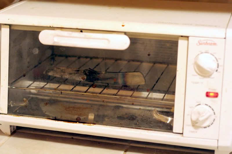

When I do my tempering in the kitchen oven, each time I take the blade out I test it with a file for hardness. You could even use a knife that has a known hardness and compare it to the one your tempering. Test after each cycle how the file bites into the steel until you get something that is not too hard, but not too soft either.
