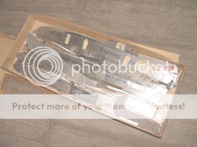

Tramontina has most variation in Heat treat, quality, and workmanship I've seen. Give me anything over a Tramontina if possible. I know it sounds like I'm spouting stuff without research, so here, all of these are broken from testing:

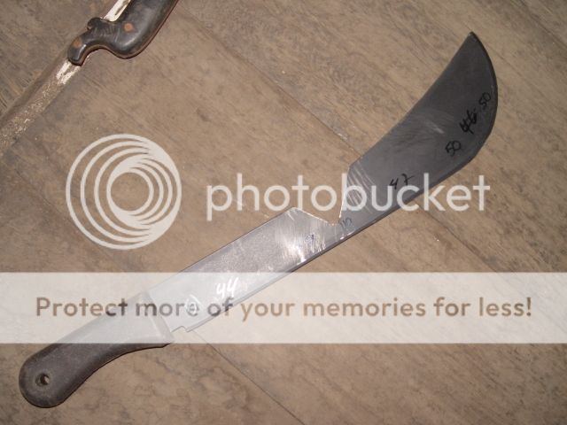

Which doesn't tell you much, but lets just say its worse than this lasher that was tested.
wa.... the triangular bite is really....:eek: Is it a Cold Steel Panga? How to make such a deep bite?
sound you prefer Imacasa/Condor... :)
Are those Rockwell numbers on that notched blade? If so, there seems to be a lot of variation.
It's a Lasher Tools panga, so yes it's a Cold Steel. :D Cold Steel contracts their machetes through Lasher of South Africa, with the exception of the out-of-production Chinese made models. The panga is a "stock" model so the Cold Steel ones are simply rebranded by putting a different sticker on 'em. Personally I like Tramontina better than Cold Steel/Lasher, BUT my preference by far is for Imacasa/Condor. My favorite manufacturer by far.

Are you able to divulge the nature of the testing? Just nerd-curious. :D In terms of fit and finish I've found Tramontinas very consistent and all of them have felt the same on the grinder when Special Grading them, but that doesn't mean they aren't inconsistent in other ways.
